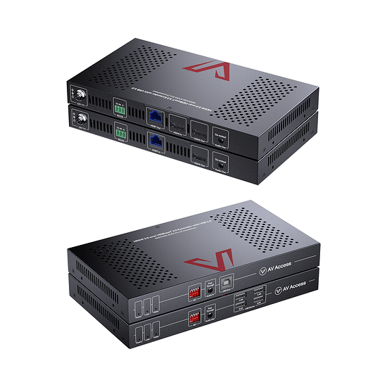

If you don’t need more than 4k@60hz and can live with usb2 speeds an hdbaset extender will set you back 350-600usd … if you need usb3 and more and can run fiber you will need to spend at least the same amount for a single usb3 extender…
This one should also be able to do 4k@120hz (albeit 4:2:0) but most importantly 4k@60hz 4:4:4 over a single cat6 cable…
They only extend HDMI though…

These are USB 2.0 only and 4k@30hz. only, and cost in the upper range of the AV connect ones that for that price can do 4k@60Hz 4:4:4 or 1080p@120hz …
Straight from the specification page

I will not argue against them being expensive but it is an option.
Right, the 4k@30Hz is for the HDMI one … unfortunately the Displayport One is not really for sale :frowning:
