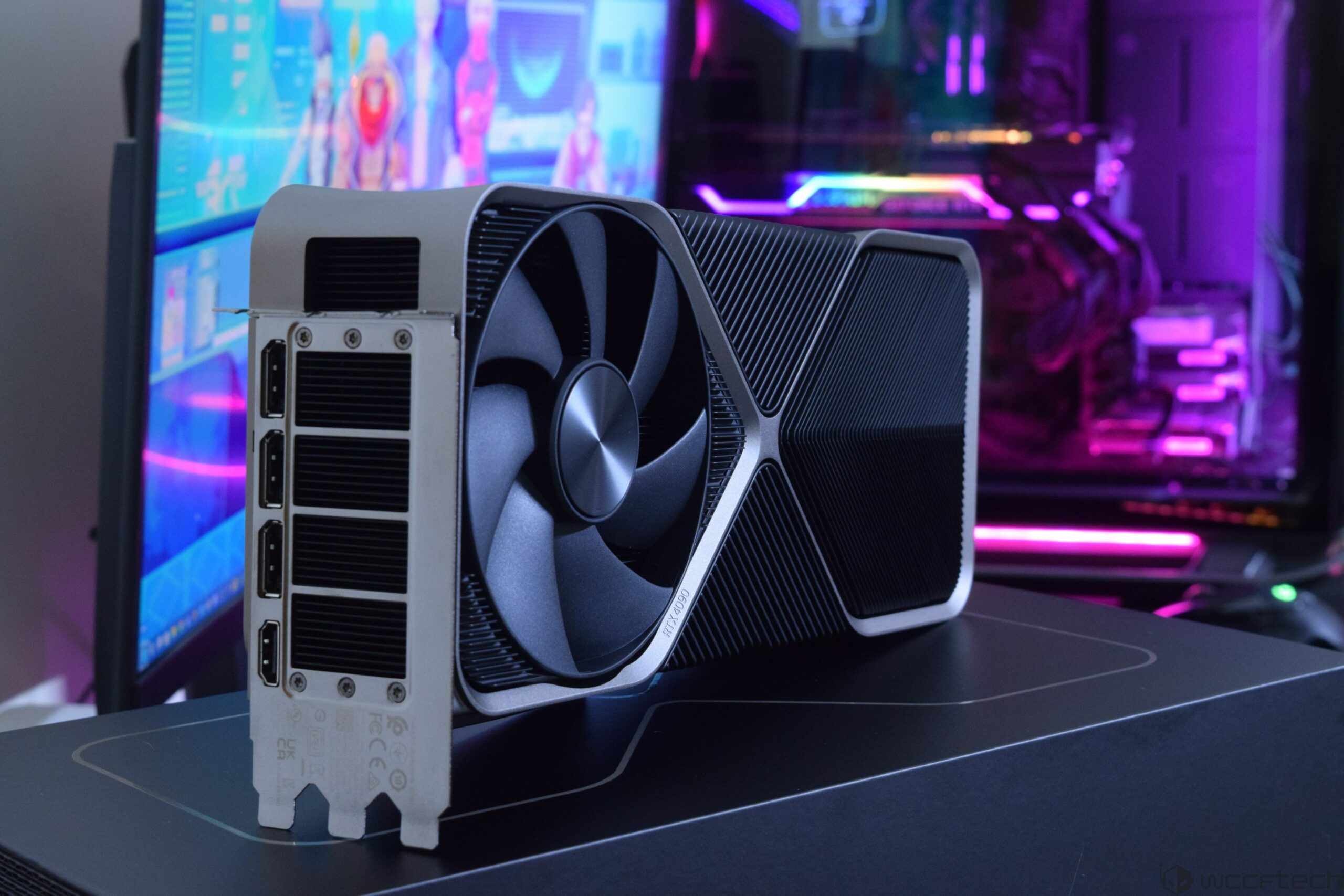

Finally, the real 5090 we were all waiting for:
:troll:

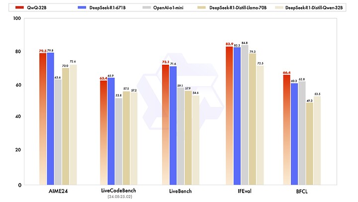

I wanna check out this brand new model that dropped today which claims to beat full R1 671B at some tasks:
I’d suggest the IQ4_XS quant, or at least no lower than 4bpw.

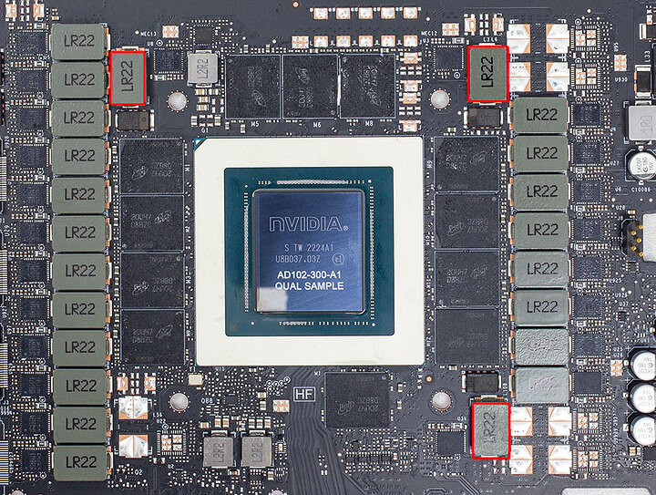

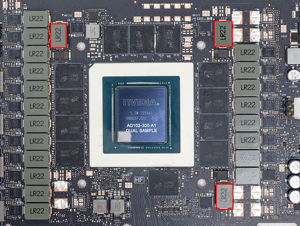

I’m not 100% sure, but in my electrical engineering experience, I believe that a skilled tech with access to good (de)soldering equipment could manually remove the existing 12x GDDR6X surface mount TFBGA packages and replace them with higher density modules.
the 12x black and almost square packages surrounding the core processor on this 4090 image from techpowerup

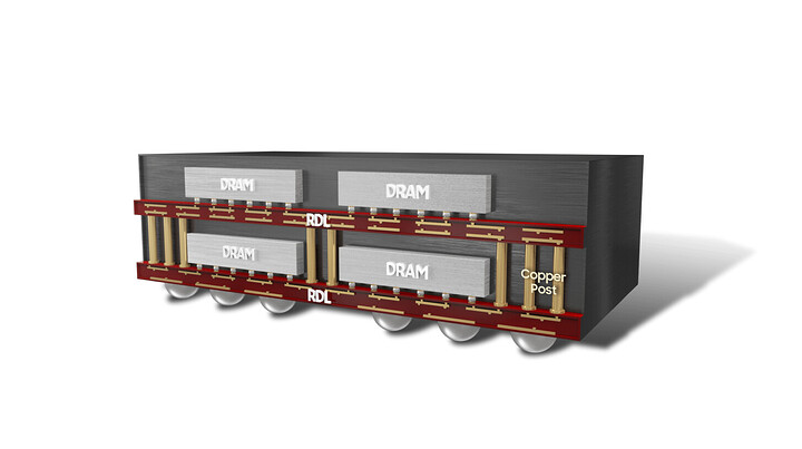

It seems like chip manufacturers are using the same physical package and P2P SM io standard across GDDR families for now. I haven’t dug up any exact part numbers from Micron, Samsung, SK Hynix, etc for a PDF datasheet. Samsung has a double density GDDR6W product that could be what they are using.
By applying an advanced packaging technology to GDDR6, GDDR6W delivers twice the memory capacity and performance of similar-sized packages.
Seems like a similar stacked wafer approach like AMD’s 3D V-Cache to fit more onto the same physical PCB footprint.

About the best I can do myself at home is like 1206 resistors/caps and barely 2mm TFQP size surface mount components manually pick and placing with tweezers, solder paste, lots of flux, a hot plate, and hot air rework soldering station. I don’t have the skills or equipment to try upgrading GDDR6X especially given its a multi-layer PCB with components on both sides.
It may also be some PCB assembly factories are making limited runs of the 4090 using replacing only the GDDR6 chips with the 2x and now 4x density variants in low quantities e.g. 100s at a time.

The 48GB variants are done by using a custom PCB that allows for a clamshell design, so you can have 24x 16Gb GDDR6X modules installed. The PCB is likely a design similar to the original 3090, which had 24x 8Gb modules.
No idea how they went with the 96GB variant tho, as far as I’m aware there are no higher density GDDR6X modules available.

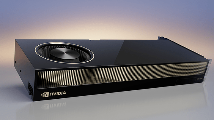

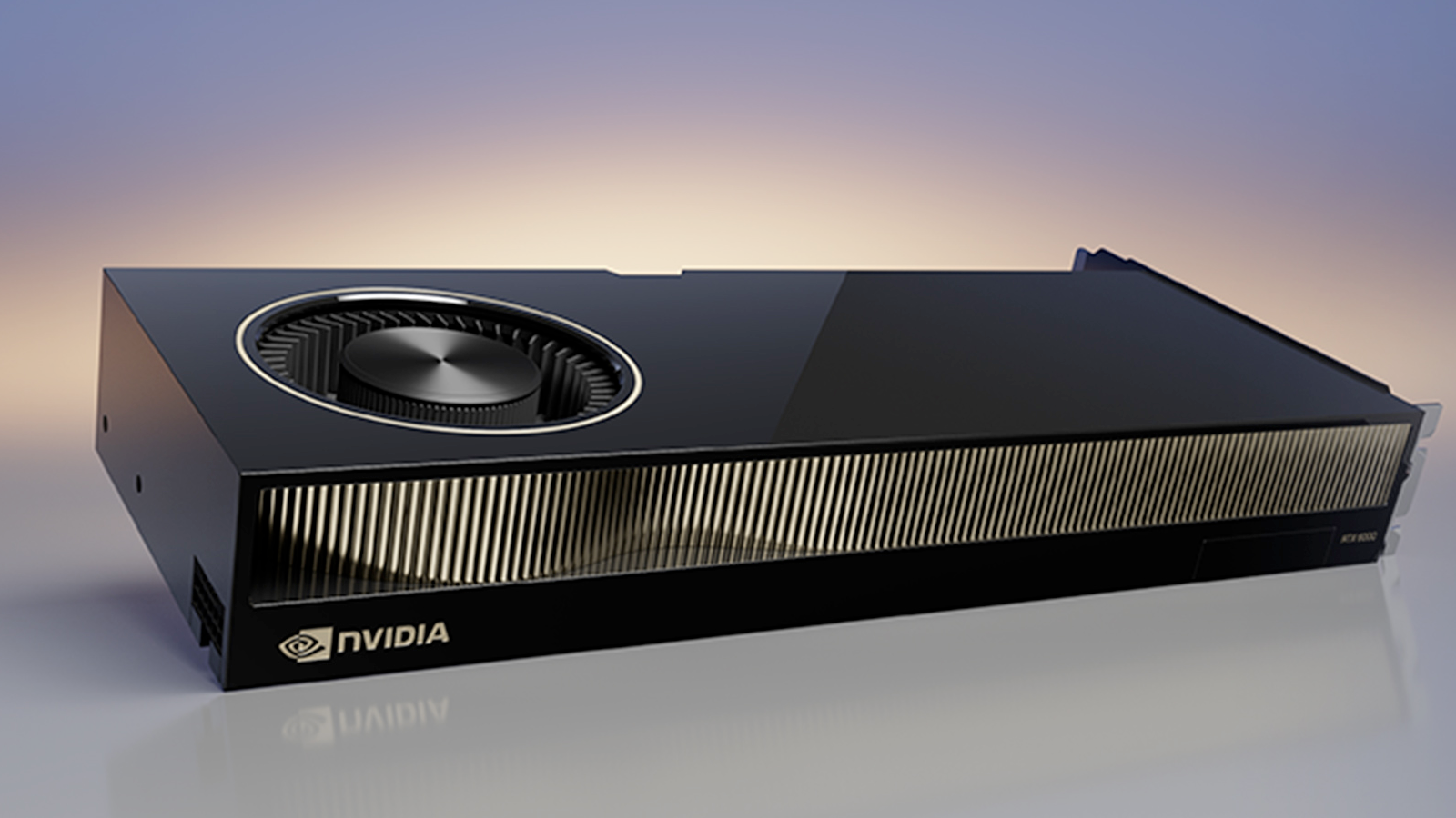

I wonder if it was just someone mistaking the 96GB pro card that’s coming soon, as a 4090.
Nvidia RTX Pro 6000 Blackwell GPU spotted with 24,064 CUDA cores, 96GB GDDR7, and 600W — 11% more cores than RTX 5090

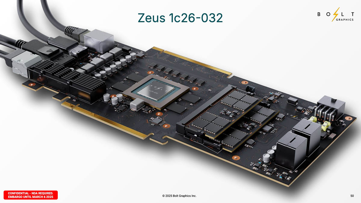

Are you making a pun about the startup Bolt Graphics Zeus RISC-V GPU with combo LPDDR5X and DDR5 (SO)DIMMs?
If they can pull it off in 2026, might have a new option for ai inferencing other than a rack of used gaming GPUs haha…

This one is a really weird design. Copy pasting what I have said in another forum:
ServeTheHome has a better post on that with more details:
Each board can have 1, 2 or 4 chiplets, with each chiplet having access to 32 or 64GB LPDDR5X, plus DDR5 SO-DIMMs, as seen in the above pictures for the 1c config.
Their LPDDR5 is rated at 273GB/s, so I will infer that it has a 256-bit bus at 8533MT/s (similar to Strix Halo, but with faster clocks). The DDR5 part is rated at 90GB/s, so I will infer they’re using 128-bit (your DIY equivalent of “dual channel”) at 5600MT/s.
Their total memory seems to be under the assumption of having 64GB LPDDR5X + 2x48GB SODIMM modules, with the bandwidth being the aggregated value from both of these.
All in all, seems like a DPU with a CPU that has a really beefed up SIMD unit. The memory bandwidth is really subpar compared to any other accelerator, and even their FP64 numbers are far from impressive compared to other GPUs that have it enabled.
It may be interesting for really specific scenarios, such as large path-traced renderings, but I don’t think it’ll be replacing any GPU farm.
For stuff like LLMs, I think it’d end up bottlenecked by the SO-DIMM memory bandwidth, which is identical to a consumer x86 platform. Going for the higher-end models (with the 4 chiplets) would likely be slower than a 12c EPYC system while also costing more.
