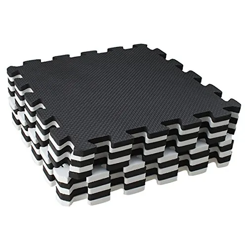

  1. Putting the speakers on cheap foam tiles [ costs ± 6 Euro’s ] highly effective against sound transmitted trough floor vibration.

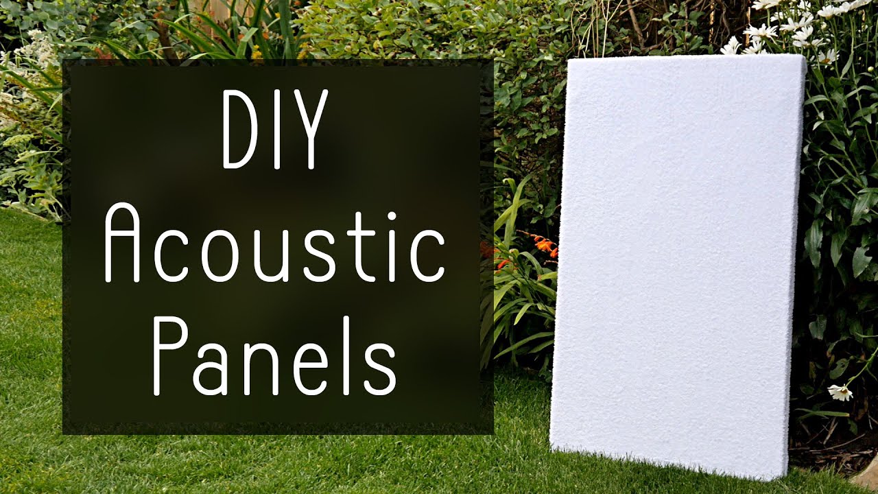

There are a number of different DIY acoustic panel solutions out there but essentially they consist of Owens Corning or Roxul rockwool or rigid fiberglass, a wooden frame, and acoustic fabric to make the panels more attractive. The acoustic insulation dampens high frequency very well but when properly placed can also dampen some low frequency. Its recommended you place panels every meter or so along the sidewalls and also in the back of the room. The ceiling isn’t as necessary but it would certainly help your neighbors. As far as mounting goes you could probably use something on the sturdier end of a picture frame hanger.
sounds expensive? is it?
I love to DIY so that’s not a problem.
Large square wood frame with cloth stretched over the front, sftudd the back loosely with what ever soft stuff you have around or cotton wool or something. Is very cheap and will go quite a way. Not the most professional or technically superior solution but cheap and at least dampens sound a bit.
Also foam panels, with egg boxes on top ponting out. Bonus points for also stuffing the egg boxes with stuff as above. Looks ugly but works.
Well I’m not entirely sure about availability in your part of the world but relative to most other solutions its about as cheap as it gets. So usually the panels come in packs of 6 and sell for around $30-40 US and the fabric and frames are also sold at somewhat similar prices and in large packs. But again I’m unsure about availability.

That’s what they look like finished. Some people build cheap wood frames and other people just wrap them in fabric and use adhesive spray and sew up the edges like a fitted sheet but then mounting to the wall is harder as there is nothing to hang off the back. The fabric has to be permeable to sound (as opposed to Zibob’s solution where it should be very heavy and dense) however my solution will definitely be heavier overall so that is a factor to consider.
