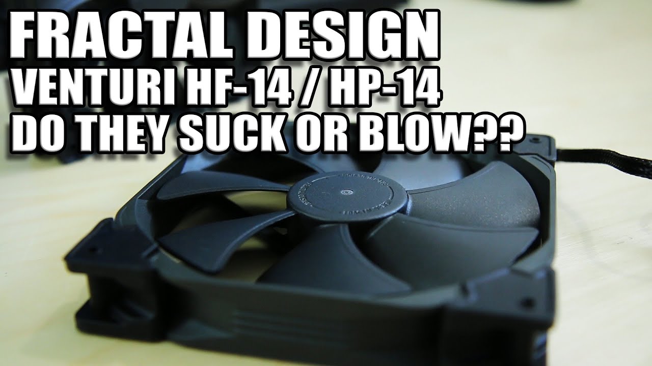

Then maybe go for fans like these, the 140mm fans can fit into some 120mm slots, so if you think that'll fit go for that, otherwise they have 120mm versions
I slapped one onto a hyper 212 and it seems to work pretty well cooling my FX 8 core

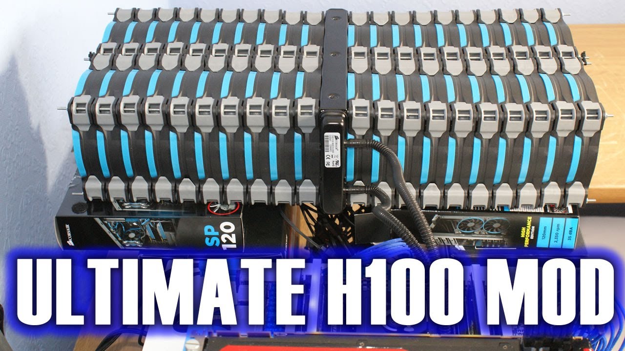

You need to put the fans in series, not in parallel.
That video is not funny anymore.
