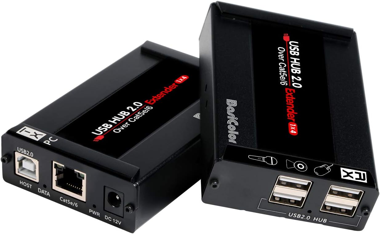

  • Any possible solution for the USB 3.0 only problem? My Keyboard etc are not USB 3.0… A quick google does not yield results, but I might not be using the right search terms.

Weird it isn’t backwards compatible but for HID or low bandwidth devices you can always use the tried and true USB over CAT5 adapters.
