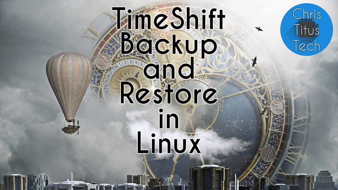

Here is a video tutorial on Timeshift from Chris Titus TV. I have never used the tool, but have heard good things about it. Very new user friendly.
