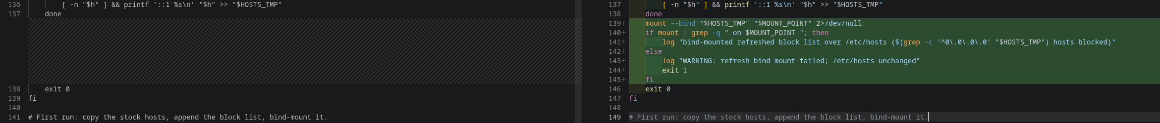

I also had to do something similar if not exactly to what awsneed had to do to get my /etc/hosts to persist through a reboot. Claude had me update lines 137-138 of the 10-block-lg-telemetry to:

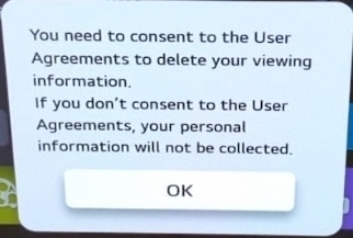

  • Within my context (see above), if you go to Settings > Support > Privacy & Terms > Delete My Personal Information > Delete Viewing Information > Delete, this is shown:
  • Due to not engaging with the voice command feature at all and not having accepted nor even seen any User Agreements/T&Cs, Delete Voice Information is missing in Settings > Support > Privacy & Terms > Delete My Personal Information, only Delete Viewing Information is present.

Regarding the scripts, they worked almost perfectly for my part using @awsneed and @mrcleantowels patches (the /etc/hosts entries weren’t updated using the initial script and the Consent / ToS state modifications didn’t survive after rebooting)
