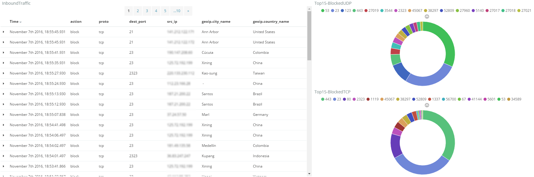

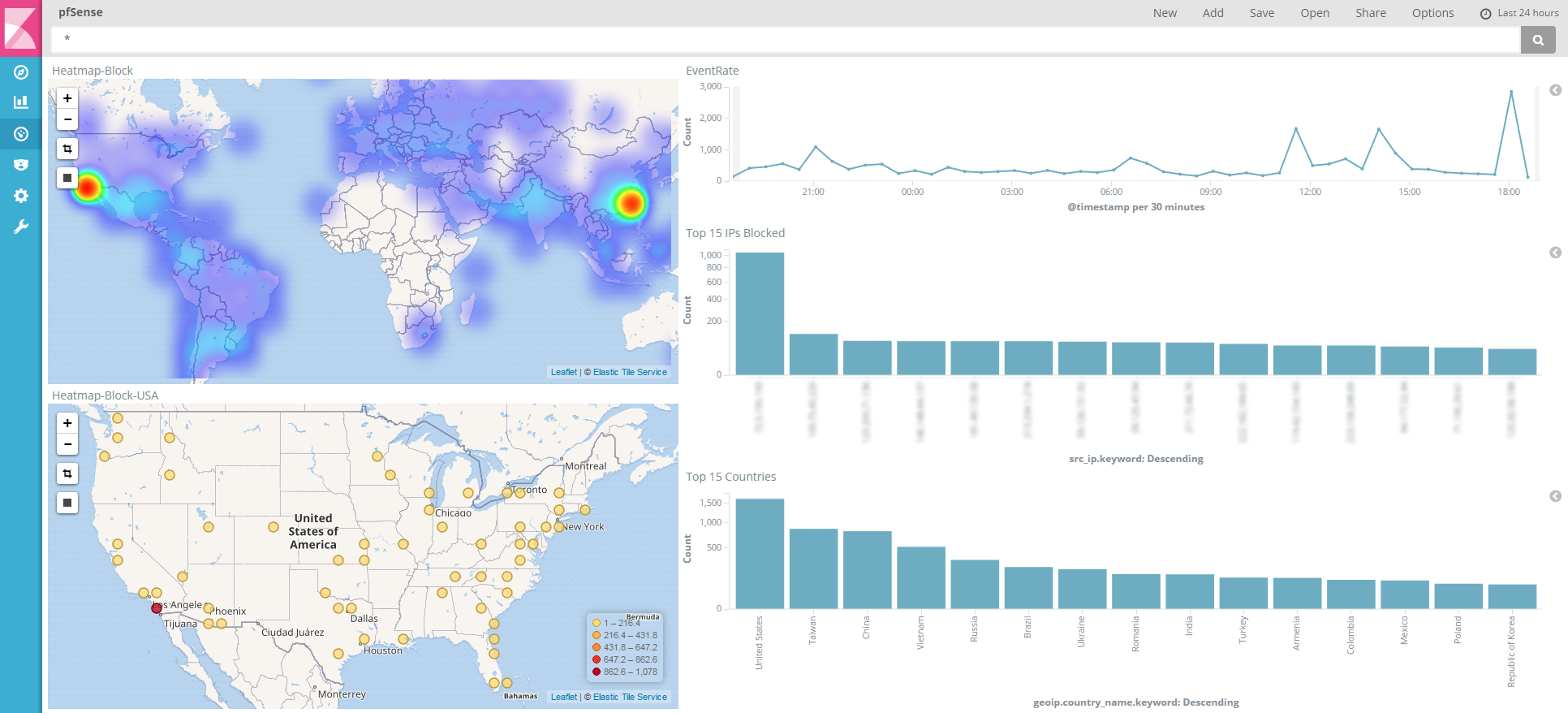

I've been using pfSense at home for several years and I've been really happy with it. It's traffic shaping alone is worth the effort to get it up and running, being able to completely eliminate intermittent high-ping/lag from bandwidth saturation has been a huge improvement over my previous dd-wrt/tomato firmware routers.
I've also provisioned an ELK/Elastic Stack VM to consume all of the logs from the pfsense box for realtime analysis. It's been pretty handy to have some kind of analytics to see whats going on and whats being attempted upon my home network.
The setup for Elastic Stack isn't really for the faint of heart, but it's worth it and makes a great addition to the pfSense router if you have any interest in network security.

Here's a tutorial that appears to be written very recently: http://pfelk.3ilson.com/2016/11/kibanaelasticsearchlogstash-plugin-x.html
I've skimmed trough it, the only thing it seems to be missing is the actual "getting started" with kibana which is the Webserver/Graphing/Dashboard side of the ElasticStack. You'll have to look up some guides on how to use Kibana and setup the "visualizations" to apply to your dashboard.
