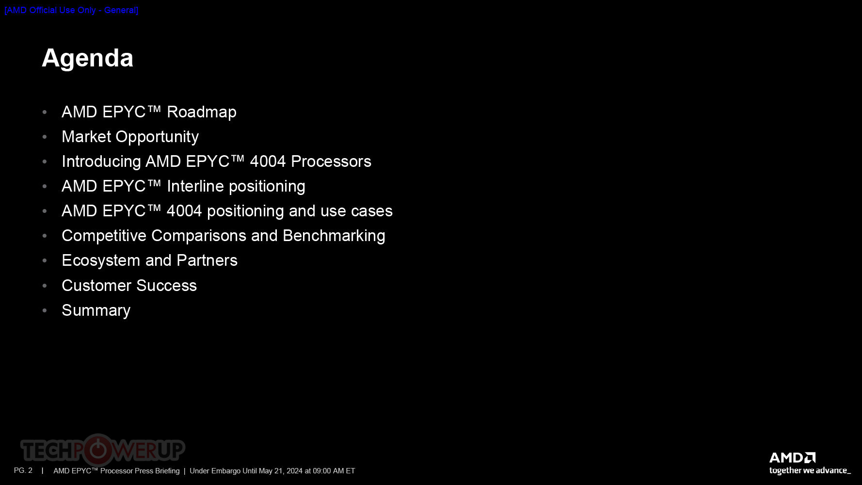

Here is one motherboard Tyan Tomcat CX S8016
  • 4 DIMM slots w/ DDR5 5200 memory support
  • (1) PCIe Gen.4 x4 slot / (1) PCIe Gen.4 x8 slot ( w/ x4 link) / (1) PCIe Gen.5 x16 slot
  • 2 NVMe M.2 2280 slots (PCIe 4.0 x2
  • 2 1000Base T LAN + 1 dedicate 1000Base T IPMI ports
  • AST2600 BMC with IPMI 2.0 & Redfish support
Another from Asrock Rack
https://www.asrockrack.com/general/productdetail.asp?Model=B650D4U3-2L2Q/BCM#Specifications
https://www.asrockrack.com/general/productdetail.asp?Model=B650D4U-2T/BCM#Specifications
