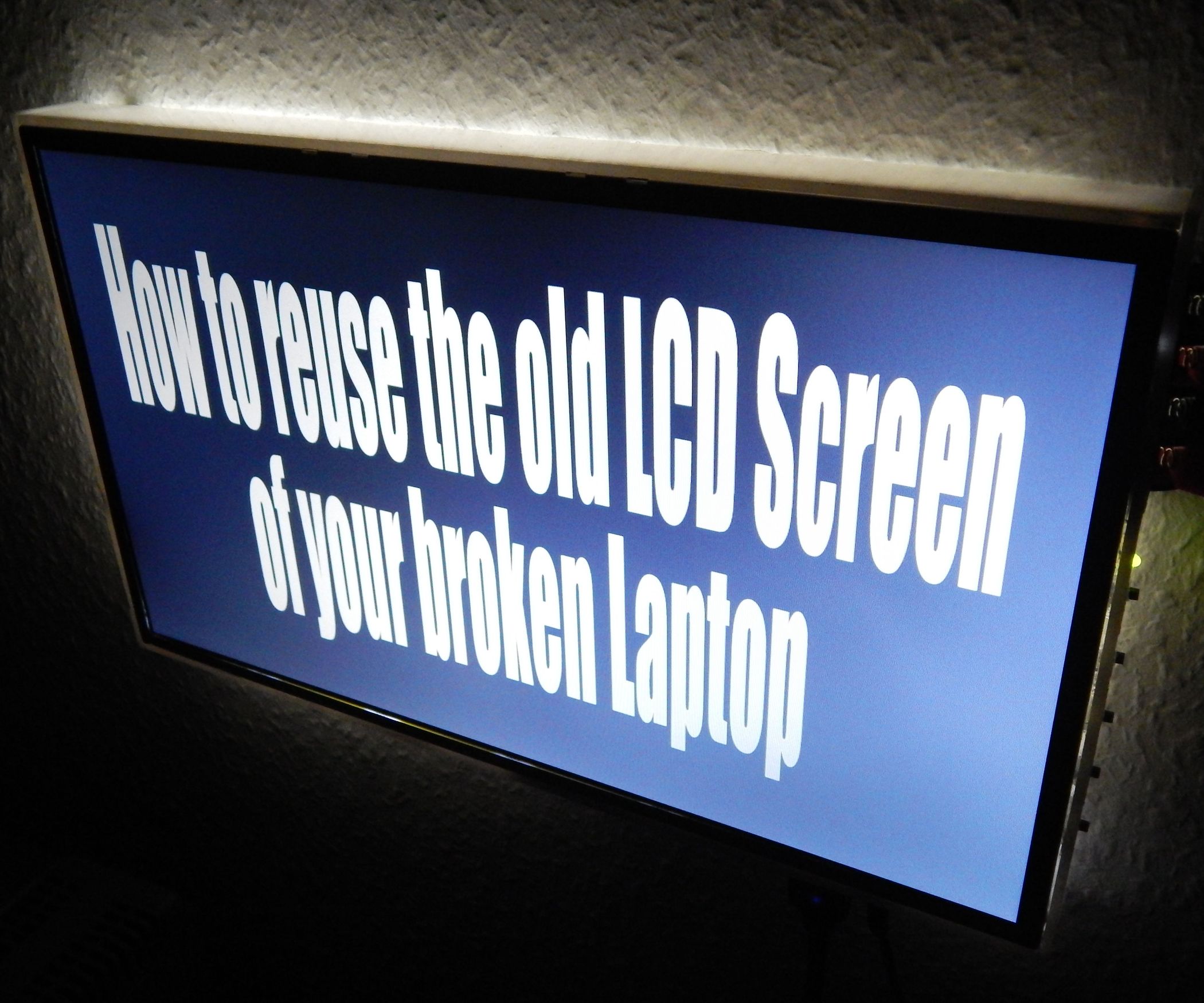

I have seen devices for sale on ebay that are basically a controller board for an lcd screen with a vga output. So you rip the screen out of the laptop/whatever and hook the controller up to the screen, then plug the vga into the controller. Then you effectively have a monitor with no stand and all the guts hanging out. I don't know exactly how it works, because I haven't tried it. It was hard to tell for sure the controller was going to work with the screen I had. My understanding is that you have to have a controller specifically made to support the exact model of the screen. To find the model number of the screen you probably have to take it apart and look at the back of the LCD panel for info. Then cross your fingers and hope you can find the right controller board. The controllers I looked at were $30-$75.

I do have a broken old laptop with a 720p screen the monitor is fine but the laptop broke. I took it apart and the mosfets came off and hard drive wont boot but monitor is still fine . Could i apply those principles to use that laptop screen as a secondary monitor?

LP156WH2 is the model number of a different lcd screen i have and im thinking of using.
That should be the link for the correct controller board right?
I have a generic hdmi cable already so all i need now is a psu for the controller board?
Where would one purchase such a thing and to what specs?

Yes, the touchscreen would make things more complicated... Laptops all have different guts so it's hard to give advice on what you should do. I'd recommend you try asking the seller if it will work, because they would be the most likely to know. Like I said, I have never actually done it myself, but really wanted to try it. If you do it, I'd be interested to know how it works out.
Im gonna buy it soon when i get some money and if it works i'll be sure to show you. Its looks simple enough. Aslong as there is no soldering and its just connecting things and turning stuff on.
