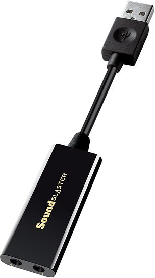

Have you tried a USB dac? Something like this?
