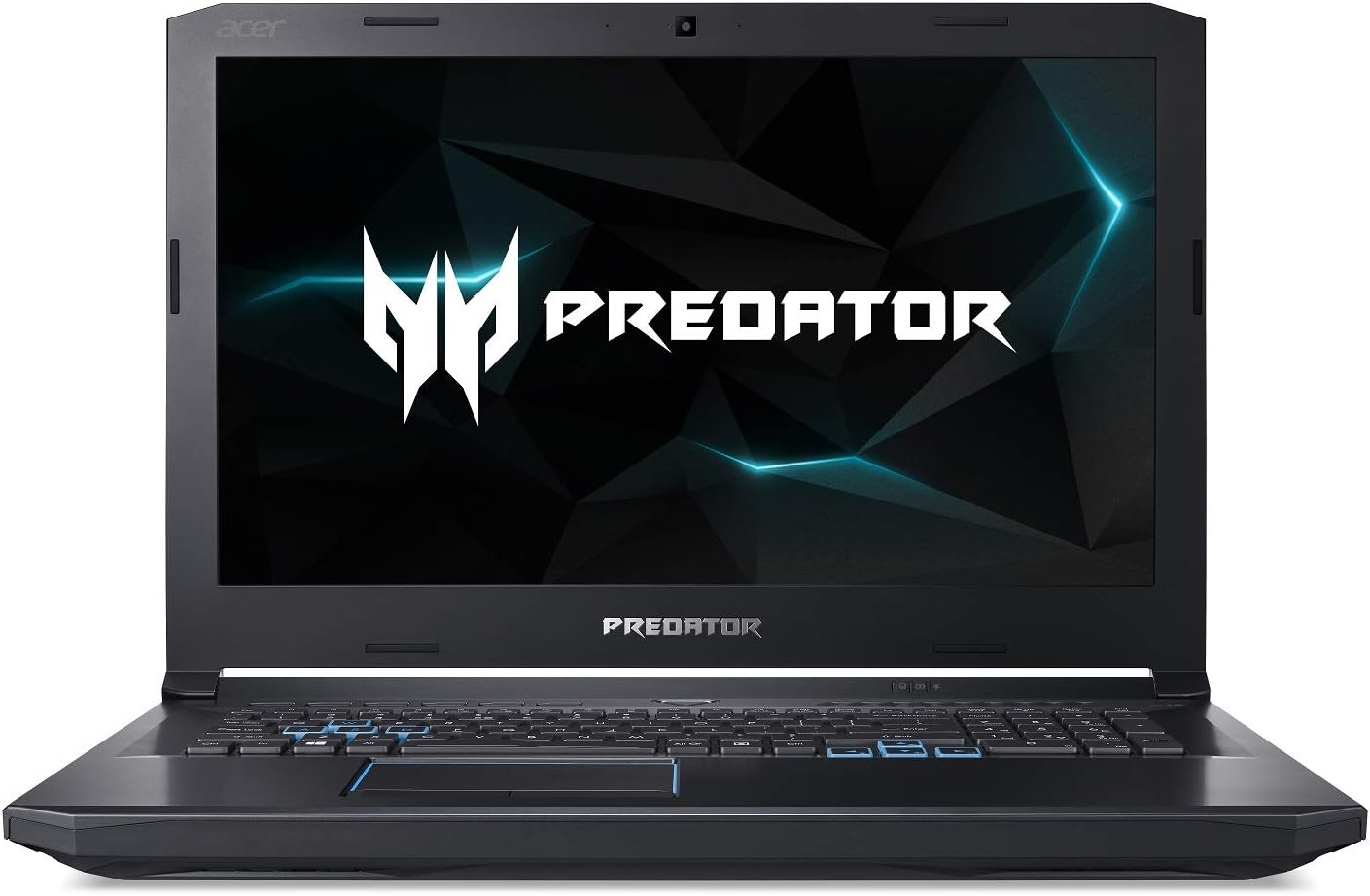

Don’t believe there ever was a mobile Vega 56 part - this is a laptop that acer have stuck desktop parts (the 2700 is a desktop part as well) into and power throttled them to fit…
It’s one of these, yeah?
Desktop CPU, Desktop GPU, but power throttled.
