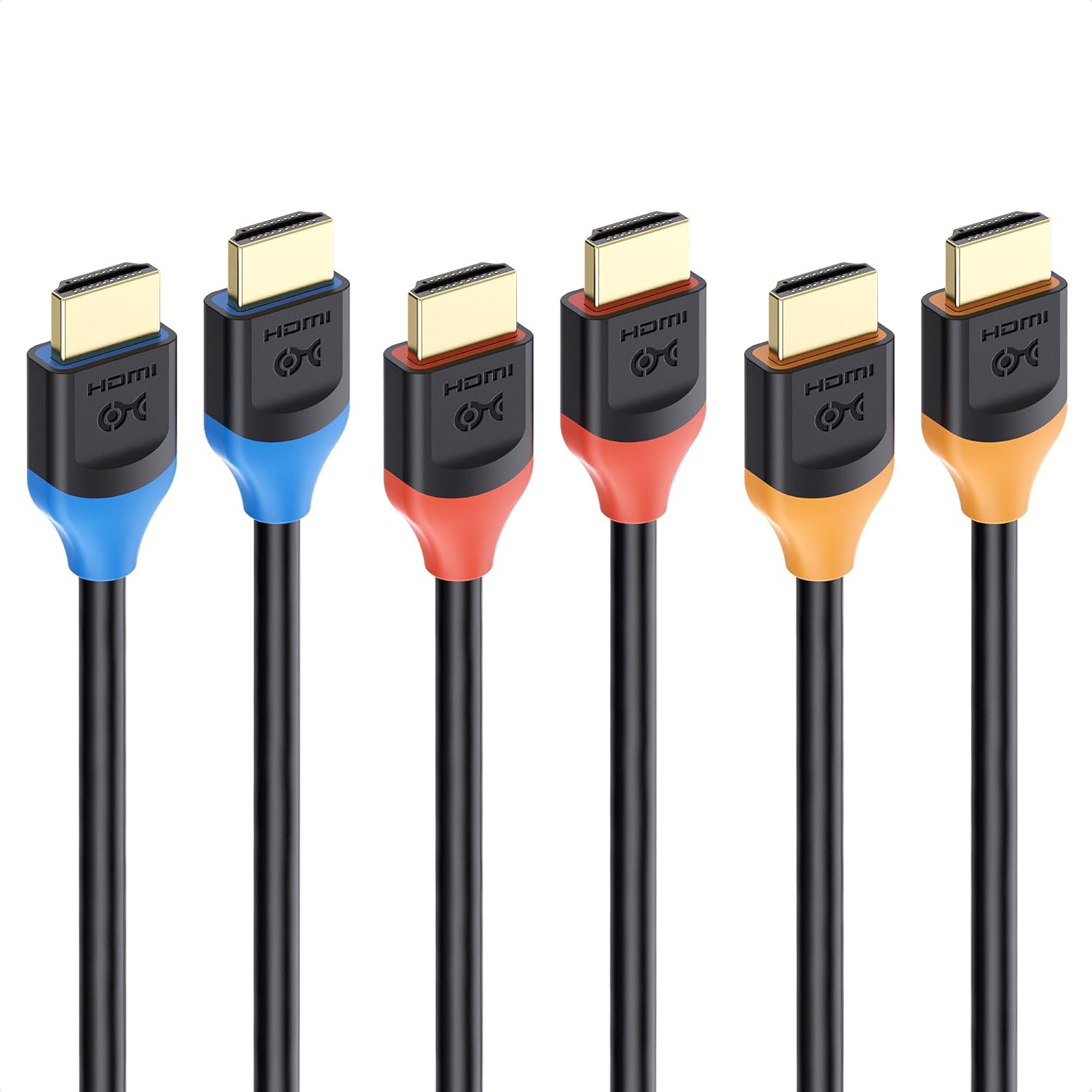

I’ve tried this setup with two different TESmart KVMs. One was not enough bandwidth for the G9 (bought the KVM before I found a good open box deal on the monitor). The second had the bandwidth and worked fine with the Dell laptop, but did not work with the MacBook in clamshell mode. I tried swapping out to shorter cables as well as bypassing the docks and going direct to the KVM. This didn’t fix the issue. The Macbook worked fine in clamshell hooked up directly to the monitor.

Flickering is almost always bandwidth-related. Connecting directly isn’t the same equation as going through a KVM, unfortunately. What cables are you using? Do you have a link?
I swapped from the stock TESmart cables to these Cable Matters in 1ft and 3ft lengths.
