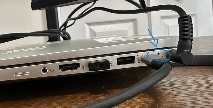

I seriously just unplugged my usb-c cord to see the brand on the underside of the plug and a monitor came up. Very strange! I did this five different times yesterday. With that being said, I have one monitor that apparently works through the usb-c/dp cable, but the hdmi/dp direct cable is not bringing up a second monitor as I was hoping. I can live with one, but the convenience of at least two would have been great.

Ok. So I’m not using the adapter, but I’m connecting a cable at the HDMI port on the laptop to the DP port under PC2 on the KVM. With that I get one monitor (plus laptop when open). The monitor will only come on when I unplug and re-plug the usb-c end of that cable into the laptop. It works, maybe not like it should, lol. I also can’t get my camera to work through the KVM but it does work when I plug/unplug it from whichever device I need to use it for at that time. So that’s not too big of a deal. Keyboard and mouse work fine.

This is the USB-C end plug to the laptop and the other end is DP at the KVM.
