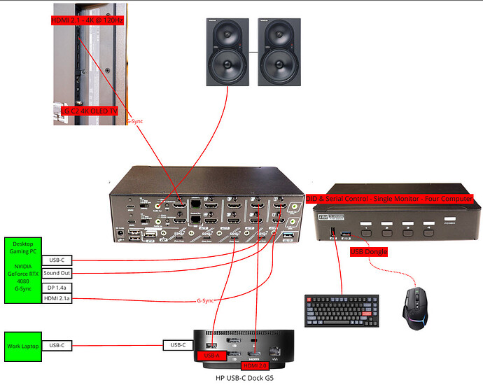

I have two PCs connected (see attached drawing “KVM.pdf”). Below are the problems.

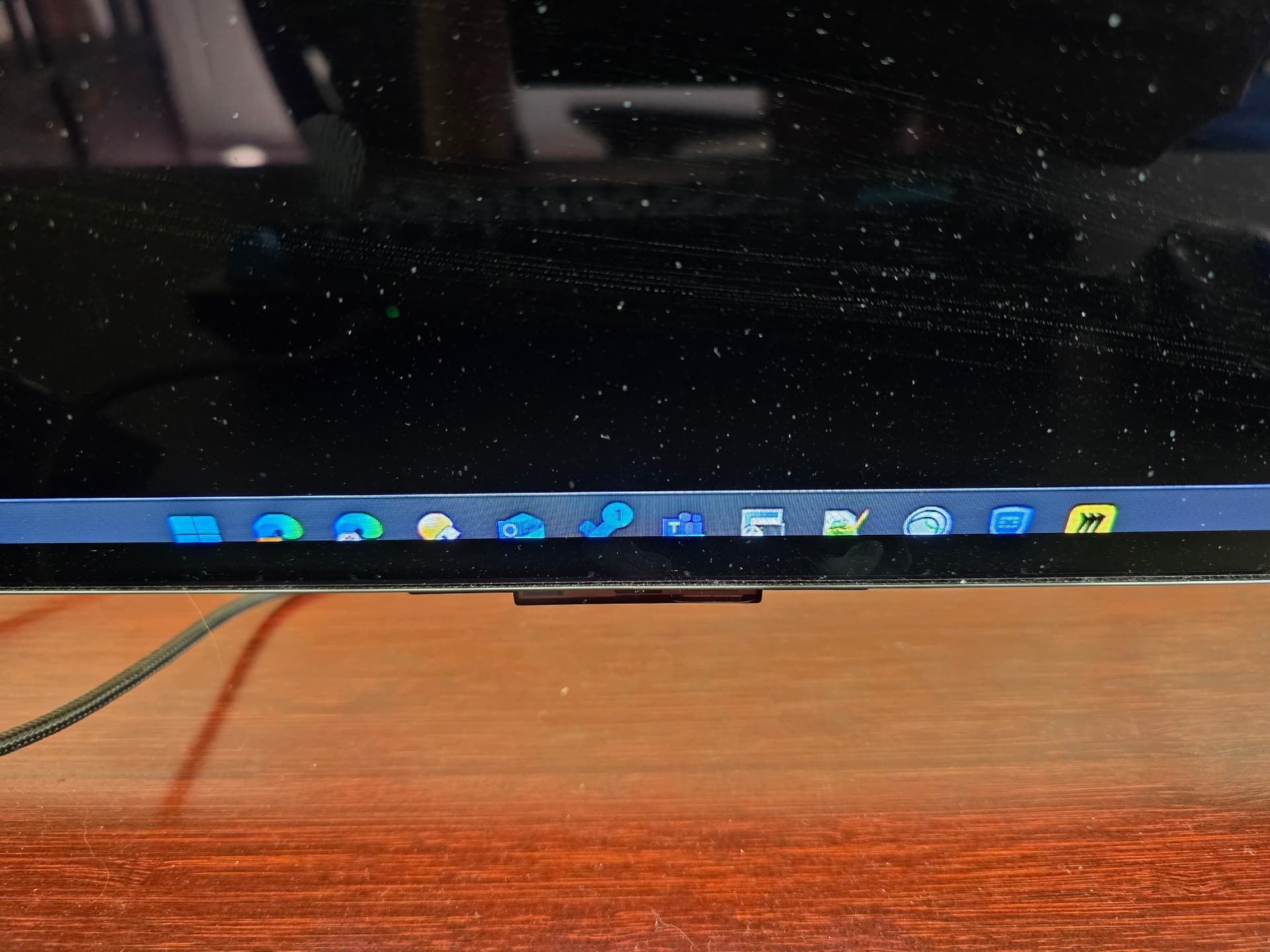

1) Sometimes the screen will be resized and expanded off the monitor (see the two attached files "screen expansion").

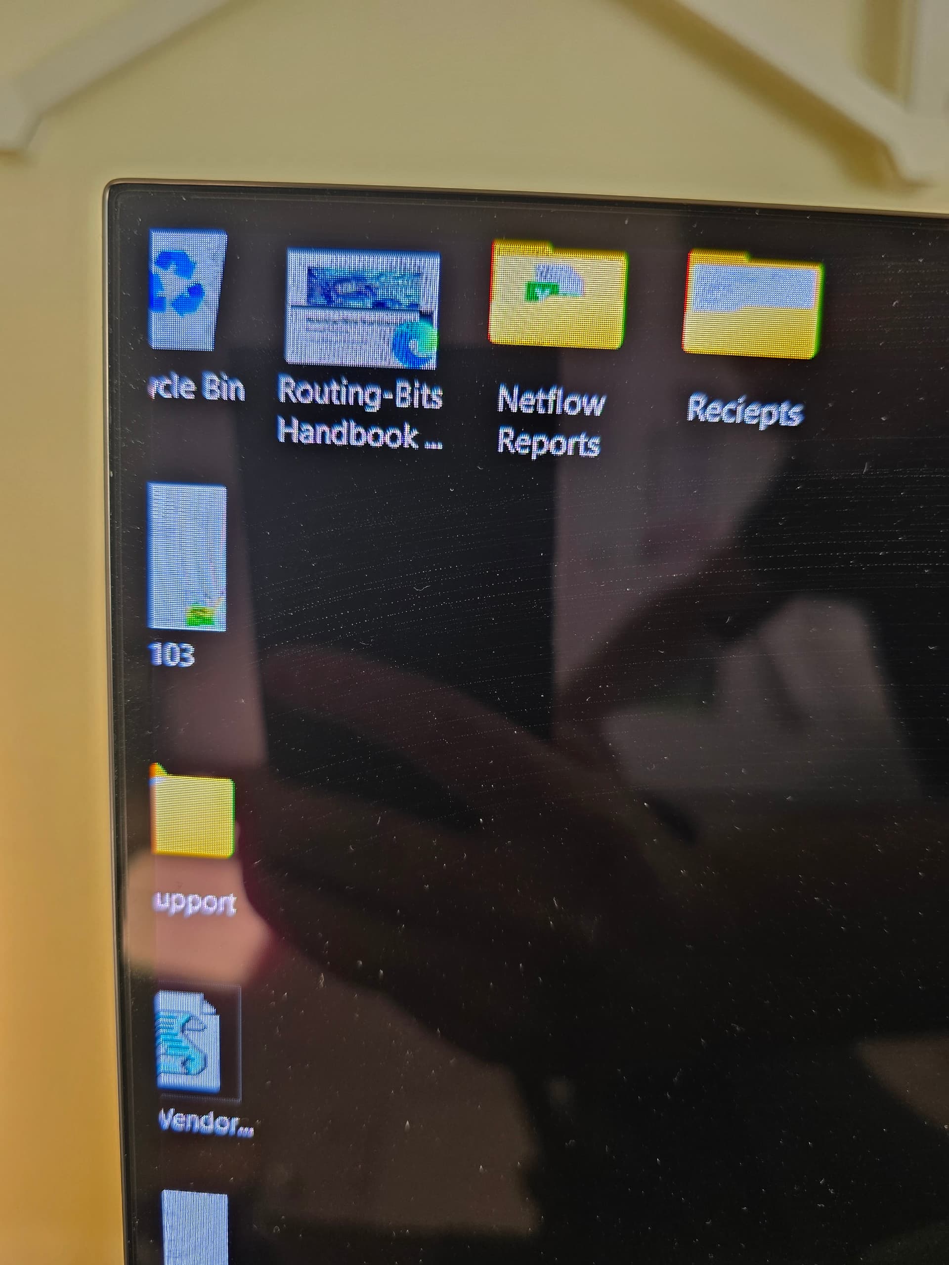

2) The screen will be blurry (see attached file "Blurry objects".

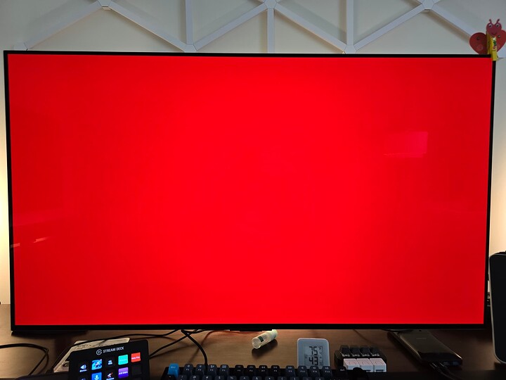

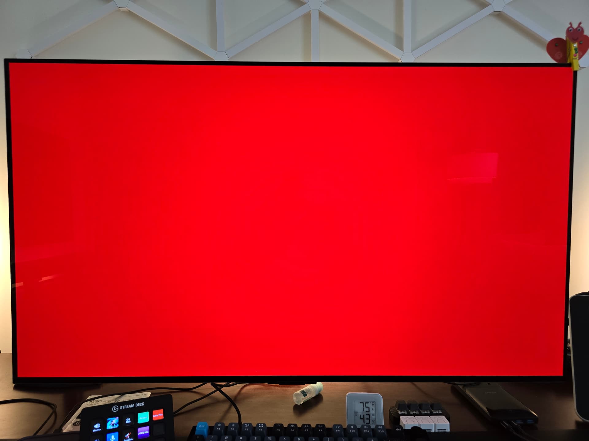

3) The screen will be solid red (see attached file "Red screen"
