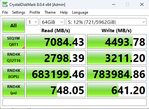

crystal disk mark of u2 intel on mcio cable
on this SSD.

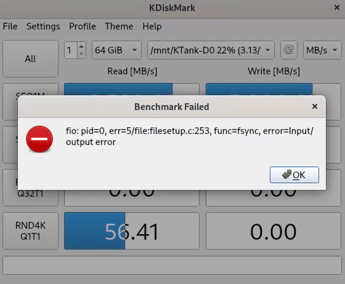

The adapter is completely unreliable—I’m getting 2-4 PCIe errors per second.
I’ve been waiting for the Deadlock 90091 for a few weeks now, and I hope it will resolve the PCIe issues.
Will share more information when it arrives.

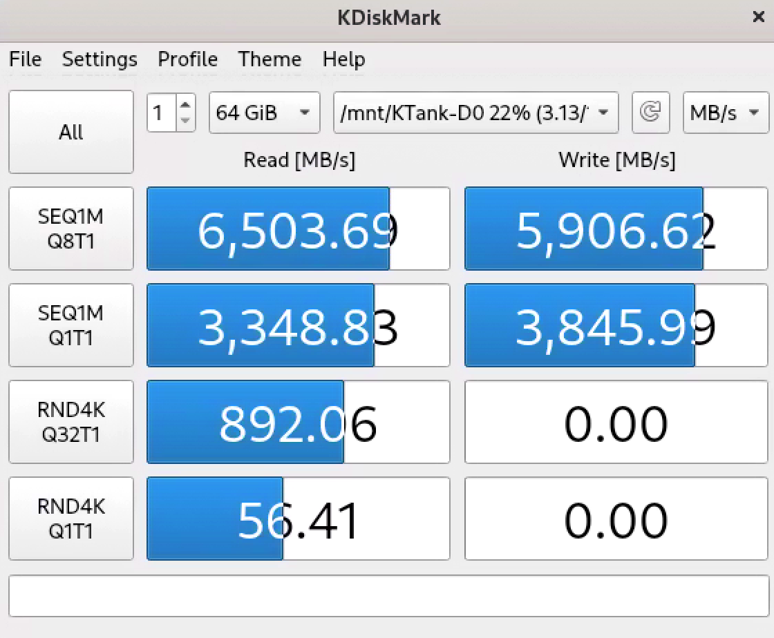

Right now I can’t even run a complete benchmark, after starting the test the error log gets filled instantly.
