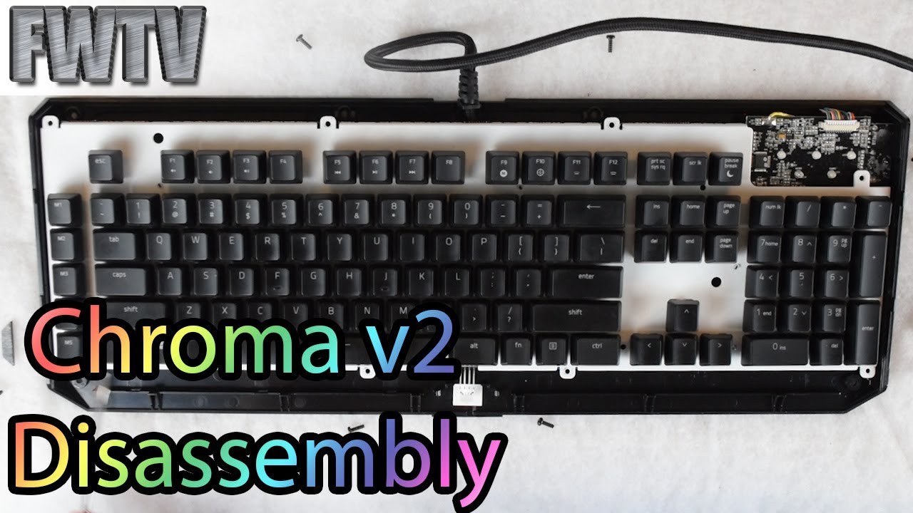

Have you tried taking the pcb out of the case? There might be some stuff underneath, or nestled in with the cables. Or there might be a little baby hairline crack in the PCB—you sent it by snail mail, right? Those mailmen like it rough.
Disassembly doesn’t look too hard:
