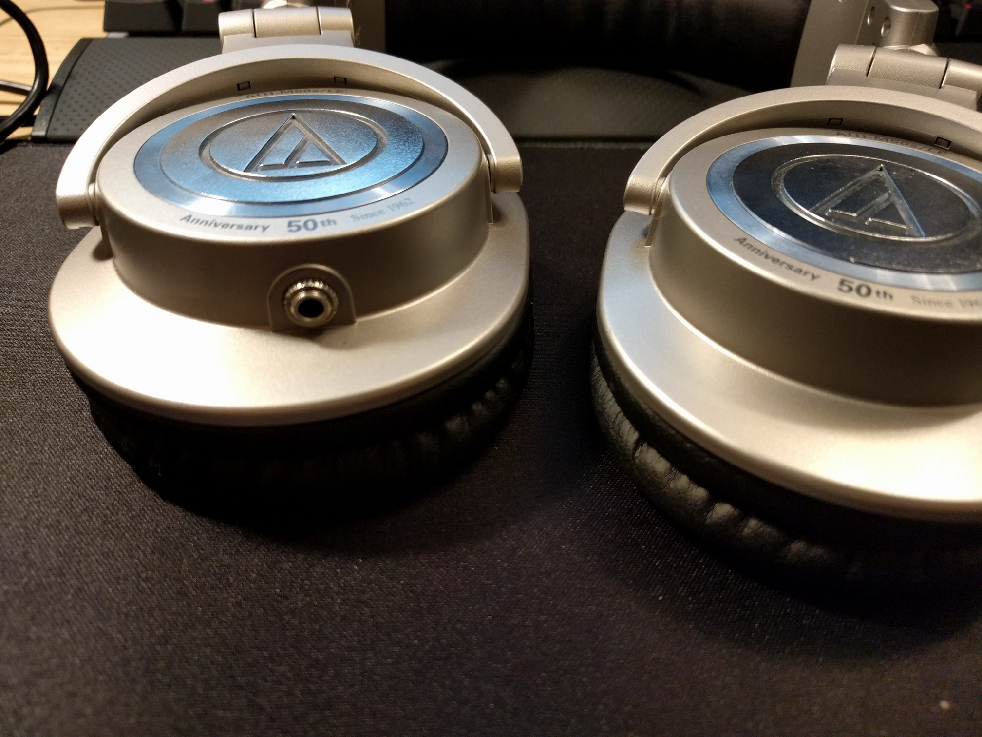

Just completed a mod on my ATH-M50s/LE Headset, wanted to share!
If this is the wrong area I’ll apologize, but I got sick of the long cable on my headsets. I found a video online of a similar mod to an older ath-m50 headset, so I ordered up some parts and went to town.
One of the early issues I faced was the delicate internal wires of the headset being damaged during the re-assembly process where the new headphone jack pressed on the wire, breaking the solder connection on the PCB.
I replaced the original wiring with 3 strands from a cat 5 cable, the added bonus being a slightly thicker wire than the stock cable.
I can take some shots of the internals if there’s any interest but here’s the finished product.
