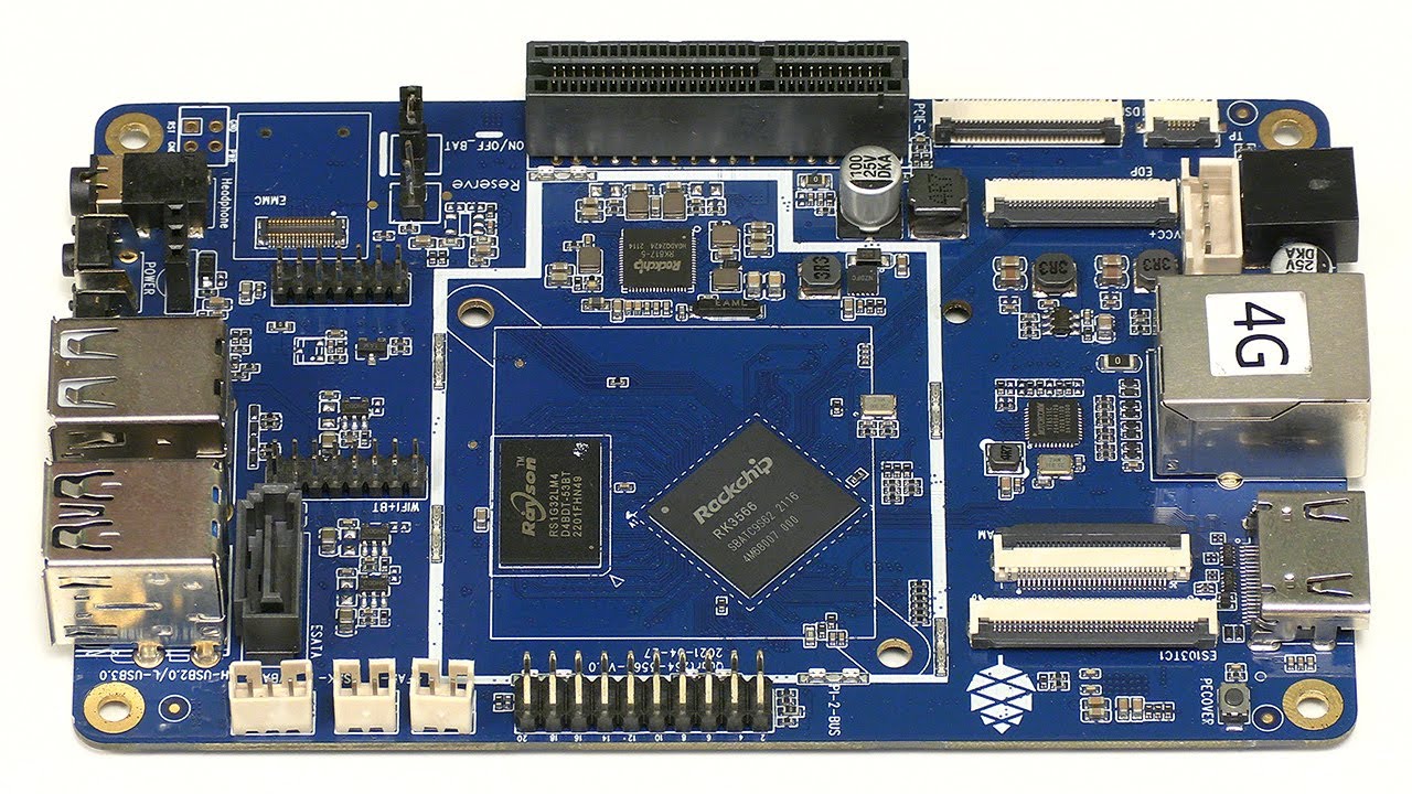

I’ve been fighting for the past 3 hours with the RockPro64. I have Tow-Boot installed on it, but OpenBSD was always failing to boot. I thought maybe it’s something wrong with OpenBSD. Oh, no. Today I just tried Alpine and Armbian and both of them are failing when trying to load the kernel from a certain address.
I didn’t manage to make Tow-Boot boot from PXE. It looks like it wants a boot.scr as opposed to a typical pxelinux.cfg. And I have no idea how to make a boot.scr with tftp variables.
Anyone knows if u-boot needs to be compiled for each board? Because if so, I’m in slightly shallow :poop:
Note: I only tried Armbian and Alpine because I already had them downloaded. Just got FreeBSD 13 for the RockPro64, will try to see if that works.
u-boot is board specific and depending on how the distro/OS boots you may need a new u-boot “binary”. FreeBSD 13.1-RELEASE works just fine.
