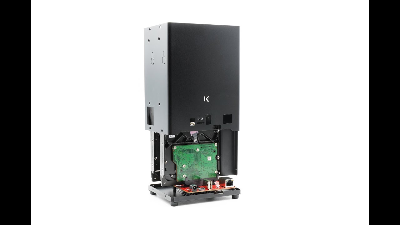

I have hit a brick wall with the amount of BS I have to deal with with the RockPro64 and official case.
The cables are putting a lot of strain on the SSDs’ connectors if you are not careful. Then you can only supposedly power 2 drives using the included power cable that connects to the rkpr64. Well, stupid me because I didn’t research it more thoroughly. I am supposed to get a 12v brick and a step-down converter to get 5v and add these to the SATA cables myself. The worst part? I have a 19v that I need to lower to 12v, so I need yet another step-down converter to get 5v.
Wow, I can’t believe the amount of BS I have to go through with this. Better be worth it to put an 80mm Noctua fan on this thing, it will run at 100% all the time (2 pins only, 12v and GND), so I need to get the lower RPM ones.
The HC4 has all you need built-in. And comes with a 15v brick and the board does all the voltage step-downs for you. But no support for 4 drives obviously. But support is not explicit for the RockPro64 either.
