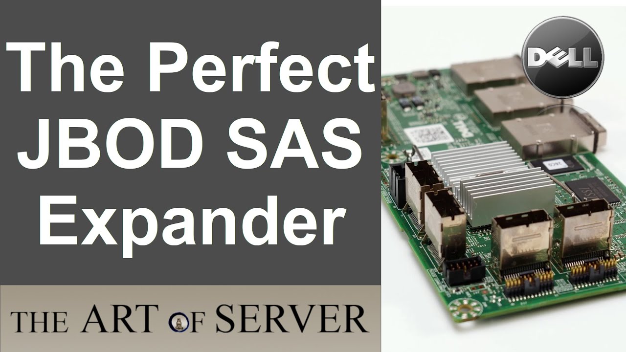

You can 100% diy one Do you have a ideal RU and drive amount?
Do you want/need a SAS expander?
This isnt the cheapest option but just an idea of how to kind of DIY a jbod
That looks great, I’ll look more into it this weekend. I’ve seen other videos from that guy, very handy.
About my setup, I don’t have anything right now. I’m thinking of getting a full tower and see how many internal and external drives I can fit in with large fans so they don’t make a lot of noise. Besides DIY in itself, I like the idea of this approach because I can add more drives and bays as I see it fit. Not sure if connecting it to 2 NAS is possible, the video talks about daisy chaining them but I don’t think it’s the same use case.
