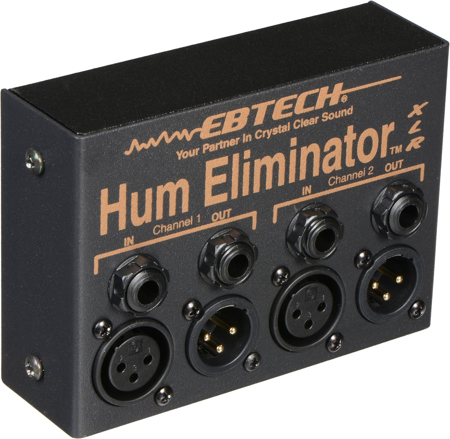

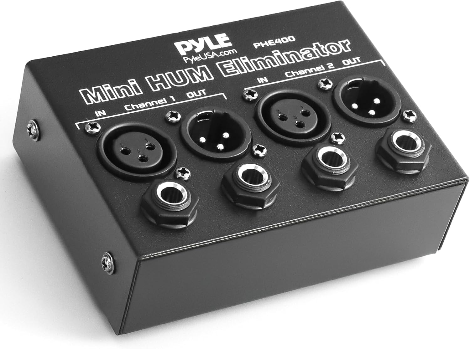

the speaker does this static or noises if there nothing on playing and you kinda can hear it on things
do i need one of this as i do have guiatar too

Make sure everything is grounded correctly! I have had some massive headaches and at the end turned out to be faulty ground on the wall plug !:scream:
