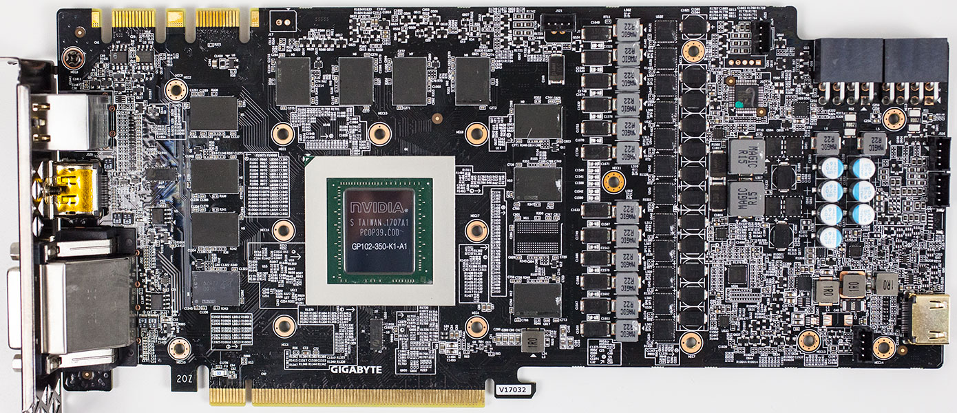

Yeah, good luck doing that on a Gigabyte GPU of recent…

Wow whats with that silk screen its a mess!!!
dont want todo that. youll leave it floating and only make the solution worse XD
