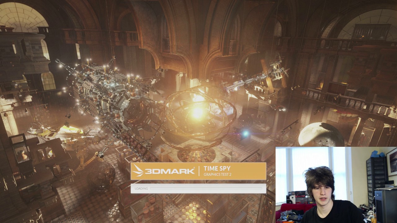

Has some good info on the cpu not idling properly ATM.

Going from the video @mutation666 posted, along with all of you answers, it seems that the BIOS/software just need more time to mature.
But the main culprit seems that even background apps seem to keep the CPU at a higher voltage state for some reason.
