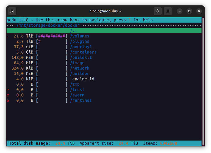

About once a week, the system reports the drive as full (df -h shows 100% usage), and Docker containers start failing or shutting down because they can’t write any data. However, when I check the actual disk usage with ncdu, it only shows around 30GB used.

Are you perhaps using -x (search single file system)? In that case it won’t be accurate since it stops at btrfs subvolume boundaries. Also make sure to run as root since otherwise not all files can be accounted for due to permissions.

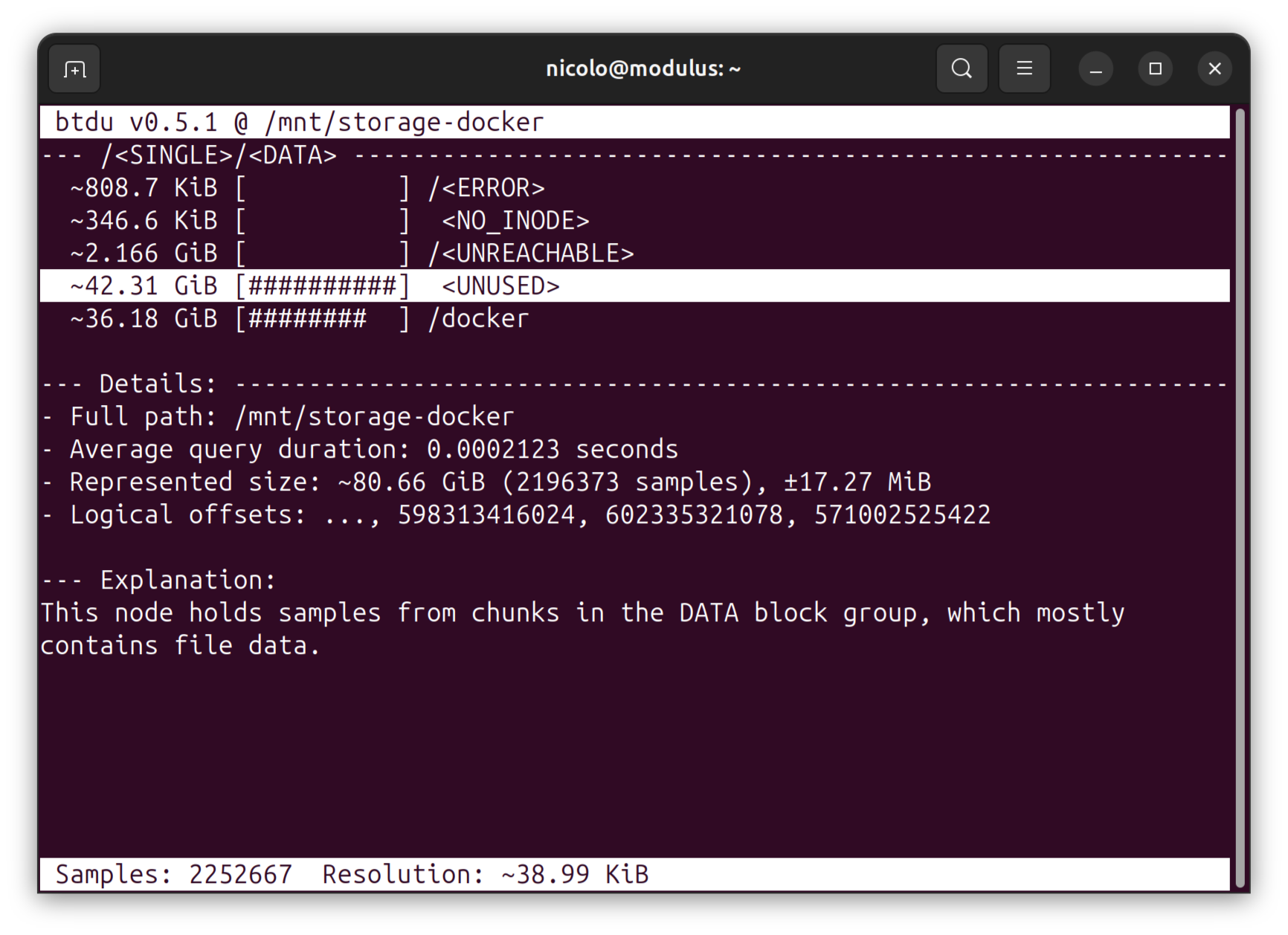

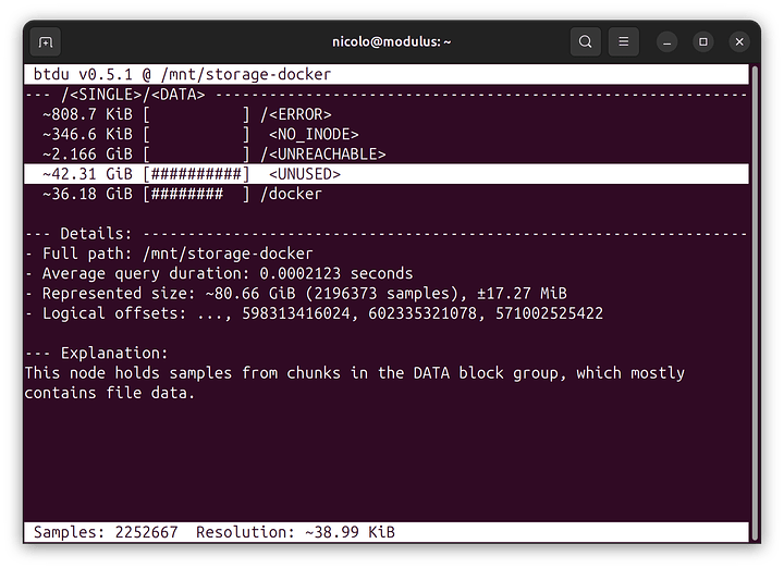

That is why I also tried with btdu. and the space he is reporting is still around 30GB and the rest of the space is marked as errors/unreachable.
Yep, running as root and with -x. but Iḿ not using subvolumes/snapshot.
Was thinking the same but btdu is showing that the fs has errors. But by restarting docker they go away… and I think docker temp files should show up on the disk tree.
Run without -x. Docker uses subvolumes for its volumes and images…

I´m gonna run without the -x but it will make 0 sense as most of my volumes are nfs shares and would show up in ncdu results.

In btdu you can see the ‘unused’ space. When the issue shows up the errors section will contains the 40-ish GB, and the 'unused’will be 0.

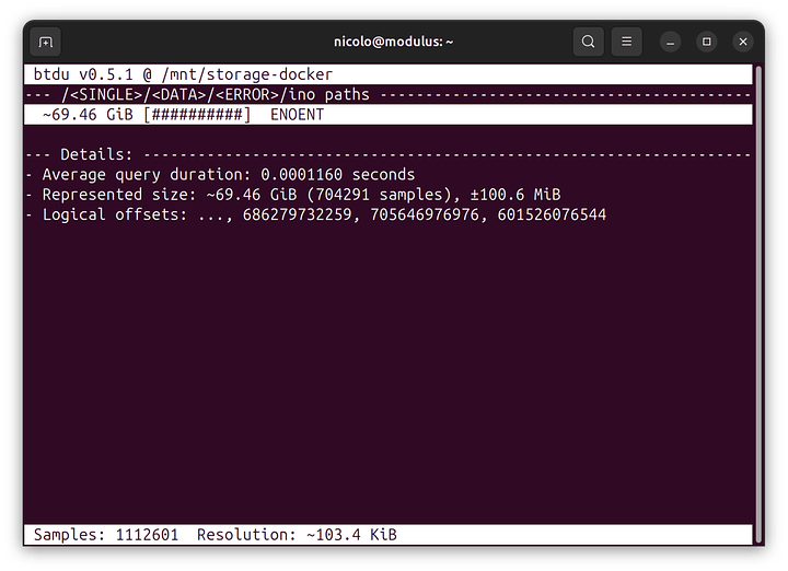

ENOENT stands for error no entry, and seems to account for the difference between the used space reported by du and df?
https://btrfs.readthedocs.io/en/latest/trouble-index.html
