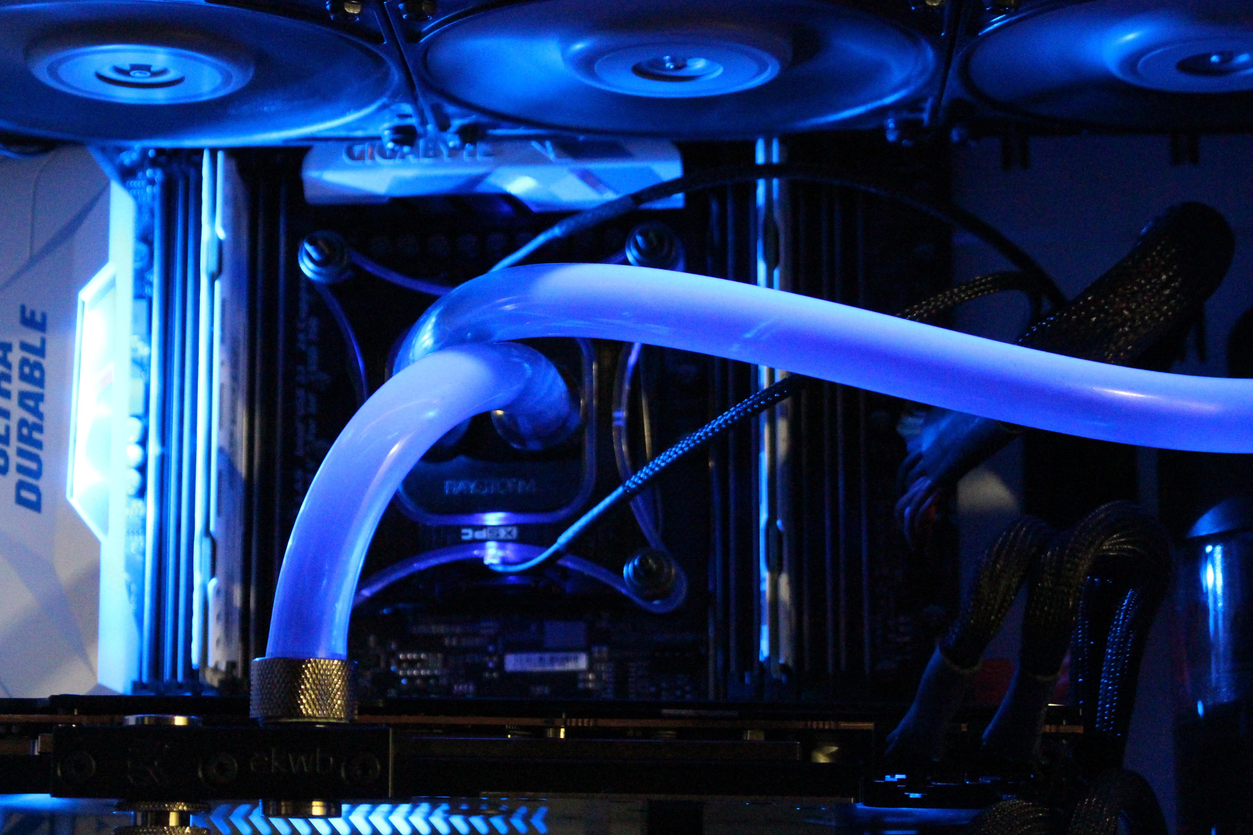

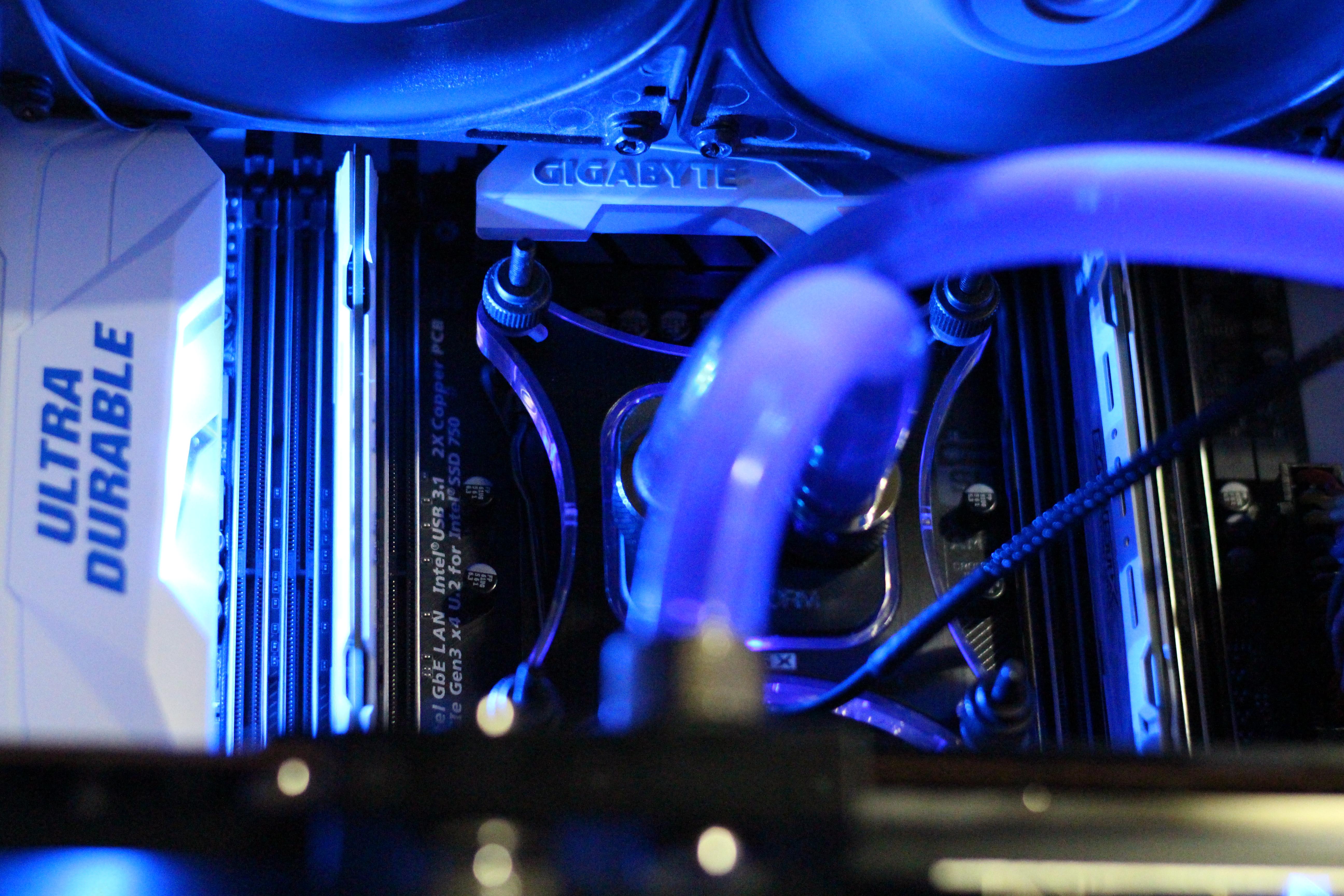

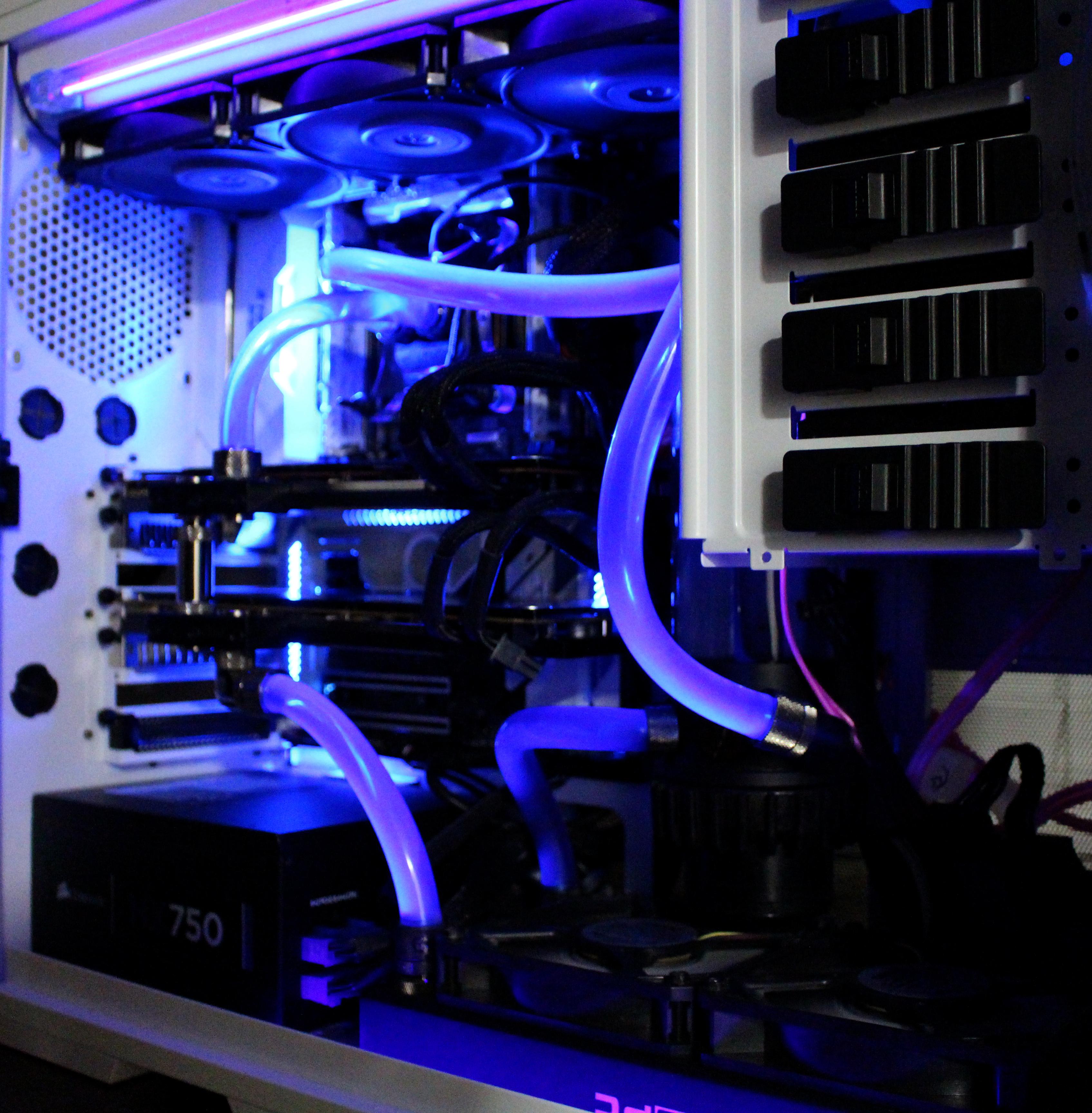

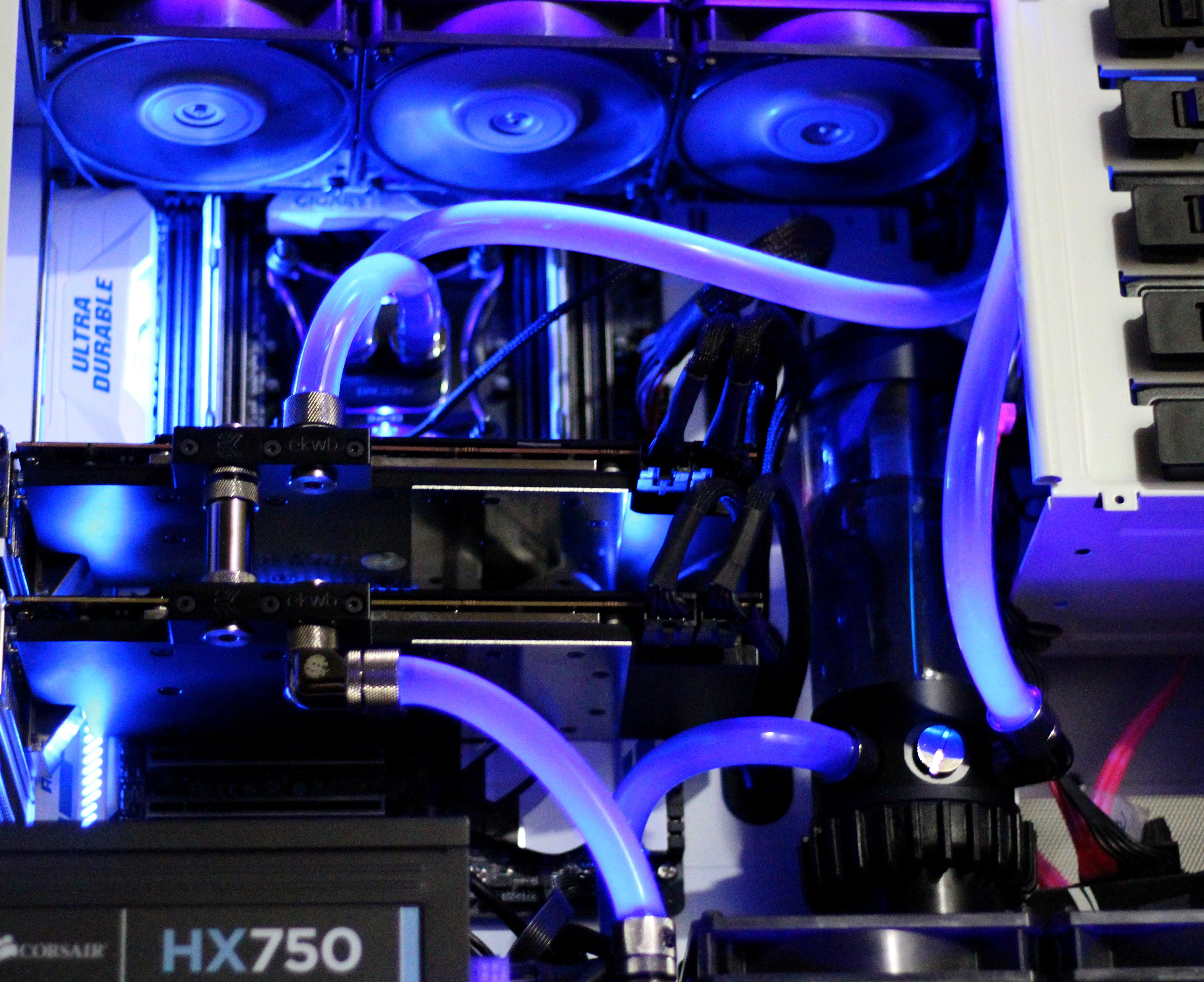

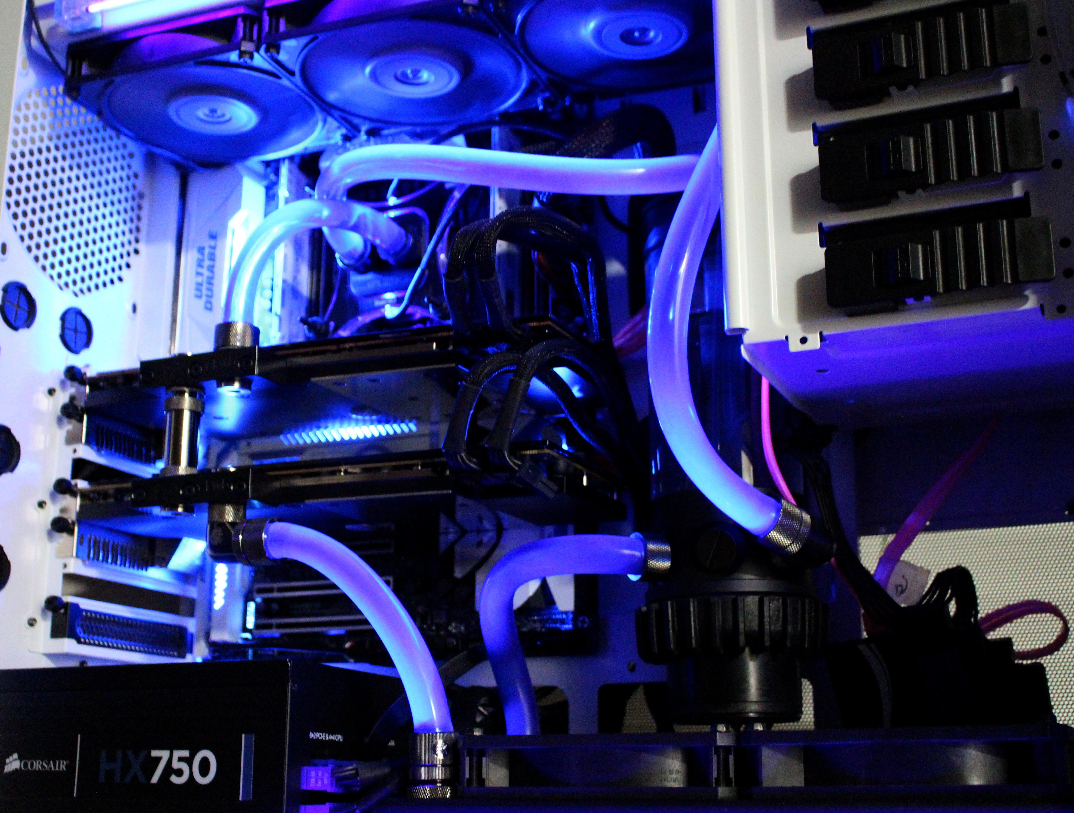

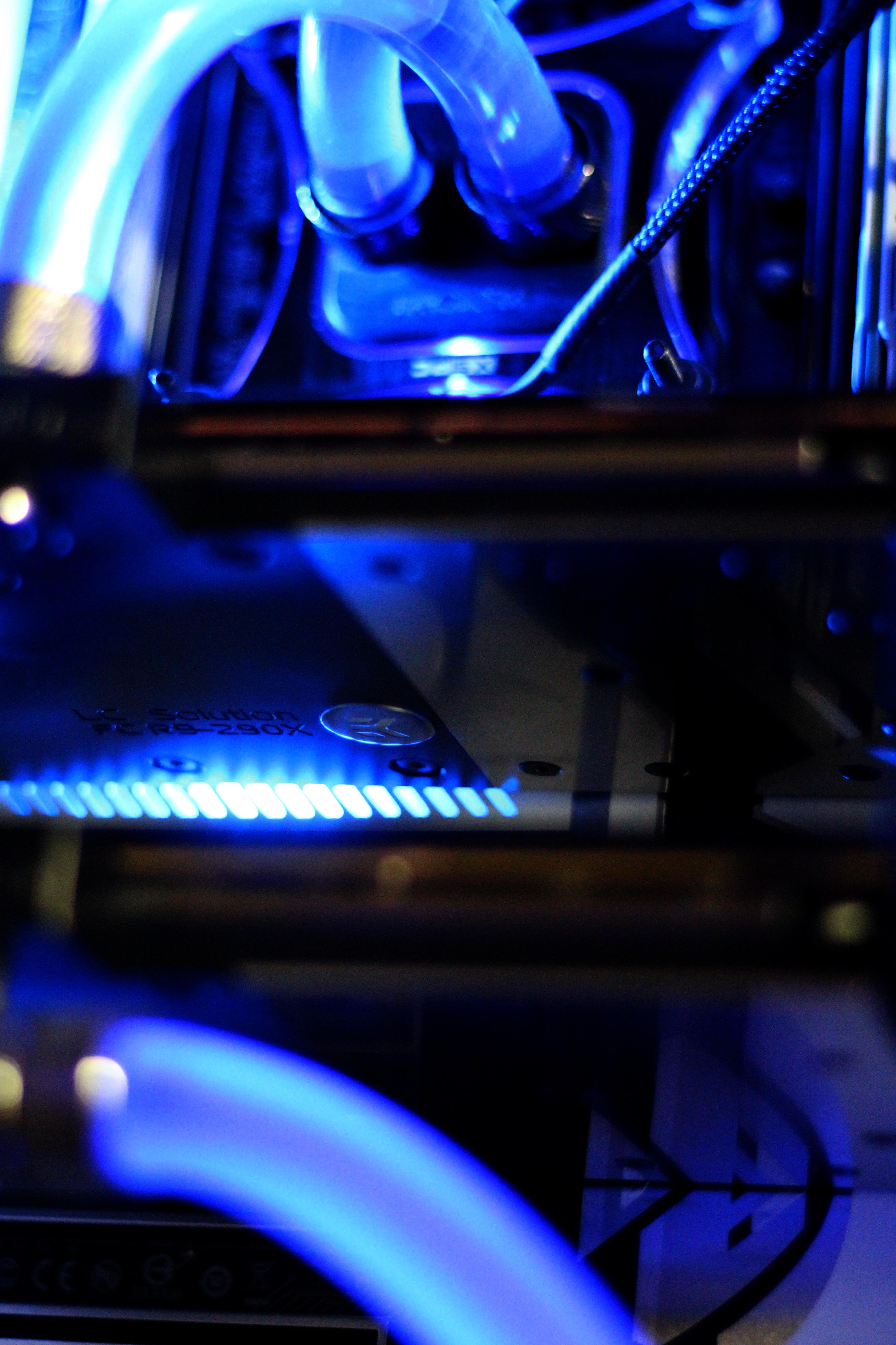

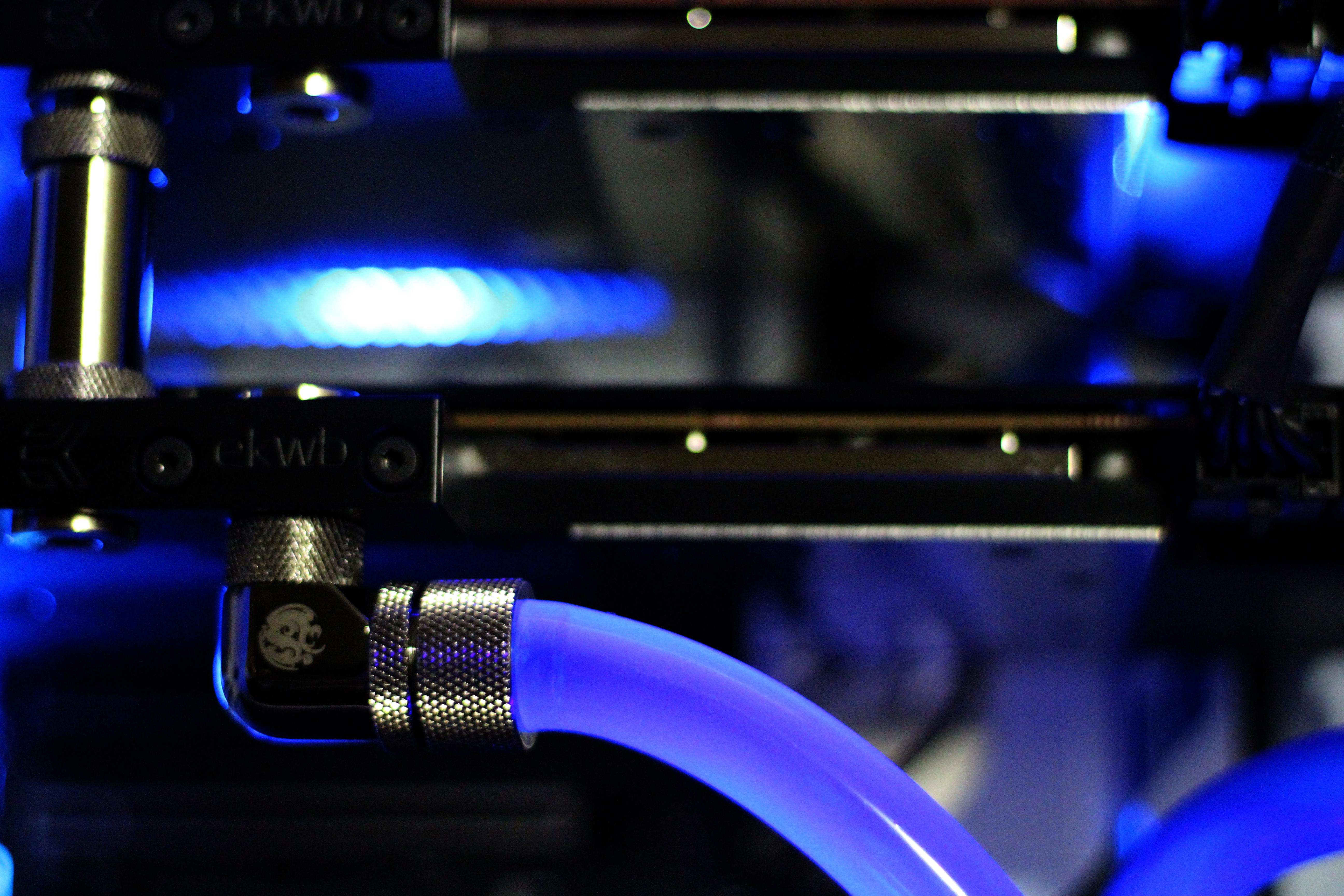

For your view pleasure, I shall include some eye pr0n as I play with my new camera lens.
Many tears, sweat and blood have led me to where this PC is now. The astute among you may notice, the SSD's dangling unmounted in the background. The award cant of the top radiator with its ghetto bracket I made from two metal plates. The woefully over stressed power supply (soon to be replacedā„¢). The dark plasticiser stain built up on the reservoir LED tube. The two sticks of DDR4 out of 8 slots. The almost bent-completely-in-half top GPU despite it having a full cover block and backplate its entire life. The numbered scotch tape on my sata cables to make sure I don't forget what RAID goes where. The upside down logo on the cpu bracket (and if you've ever fought with one of these idiotic XSPC blocks you know the struggle and why I don't care to fuck with it now).
Its still a mess to me, but I'm still happy with it. Definitely worth the money.
