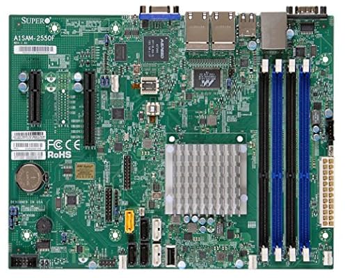

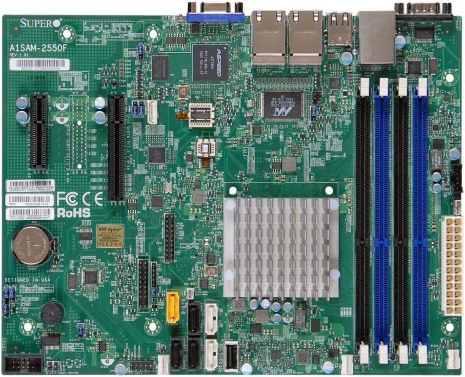

Another solution could be to return the old i3 setup and go cheap Atom+mobo combo with the second build.
