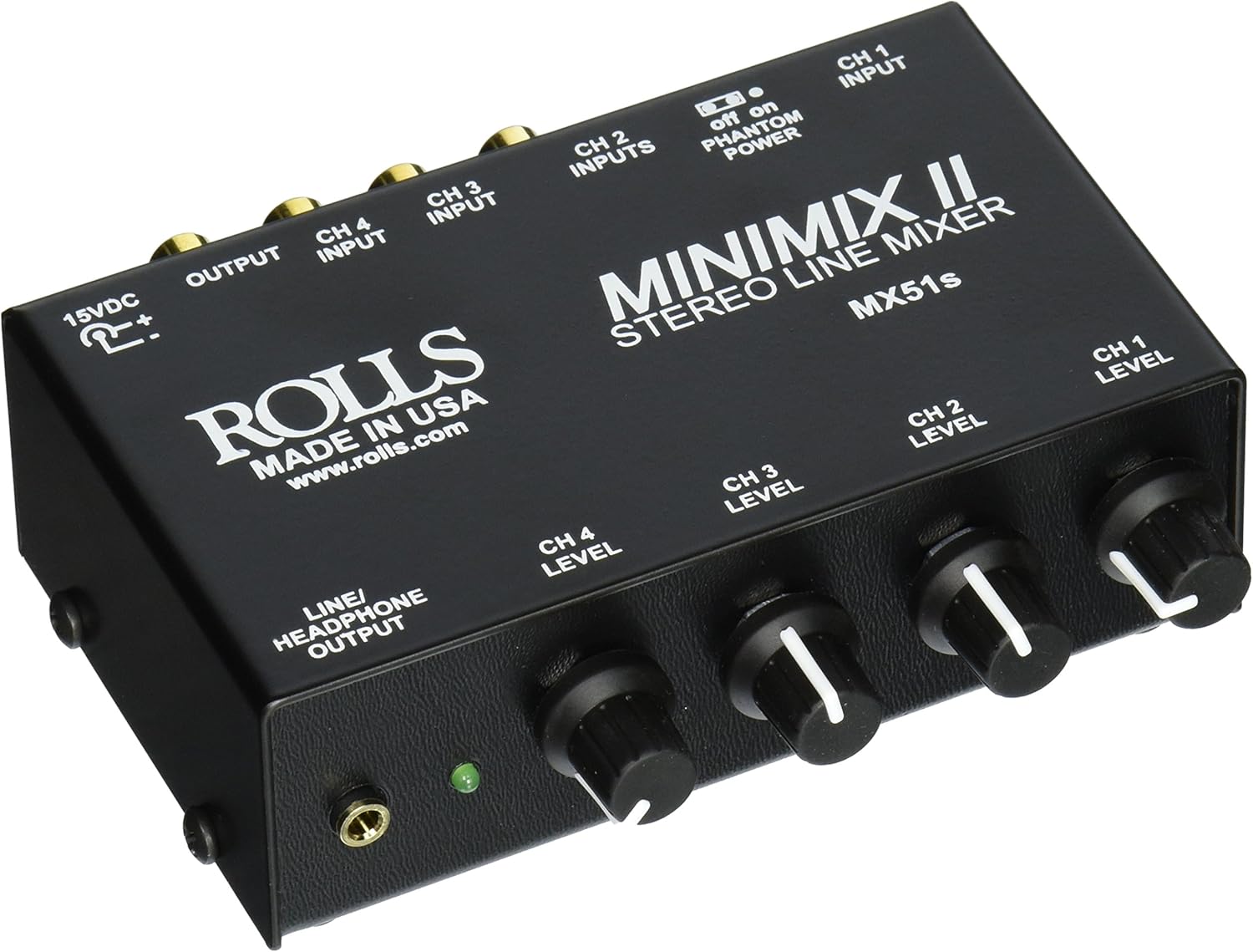

I know its not usb, but I use a mini mixer for normal audio jacks. it takes more skill to set up the audio wires to prevent noise but i have never seen a small affordable audio mixer. this solution has been working for me for over six years even with lots of noise video and usb cables. I use this with a sennheiser game one headset. then you just use a 3.5 extension cable tot get the mic back to the main computer.
I really just want a generic usb audio mixer hub.
All it takes is balanced audio connections, but these mean $$$ audio interfaces

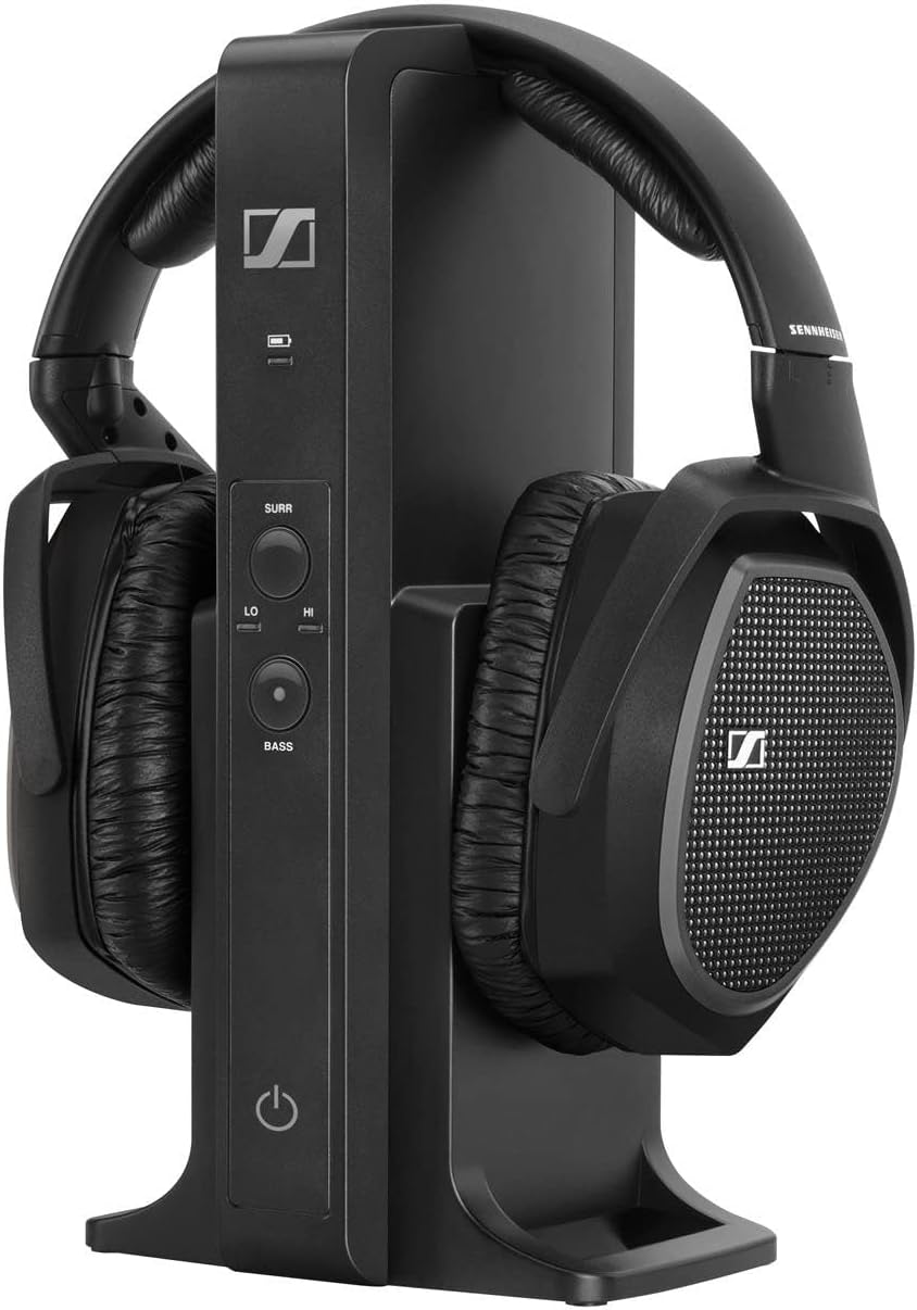

I used to run that set up with a Sennheiser wireless headset (the stand converted the raw audio to wireless). those don’t come with mics, though a wireless blue tooth boom mic should not be too hard to get.

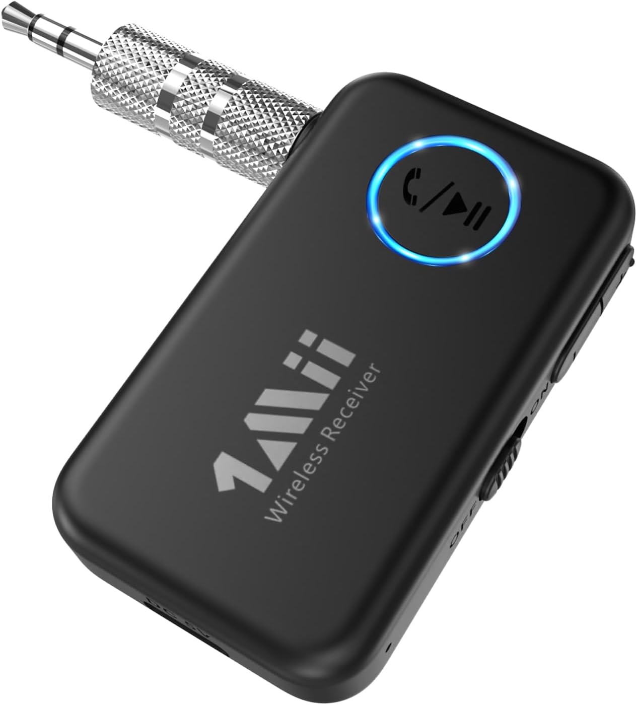

Normaly you would use a mixer and mix the analog signals, then use a dongle like this to send out the bluetooth signal *1
But honnestly i don’t like bluetooth for mixing or recording audio latency. compresion etc etc. Not to talk about noise cancelation. I Need to hear it if its noisy.
