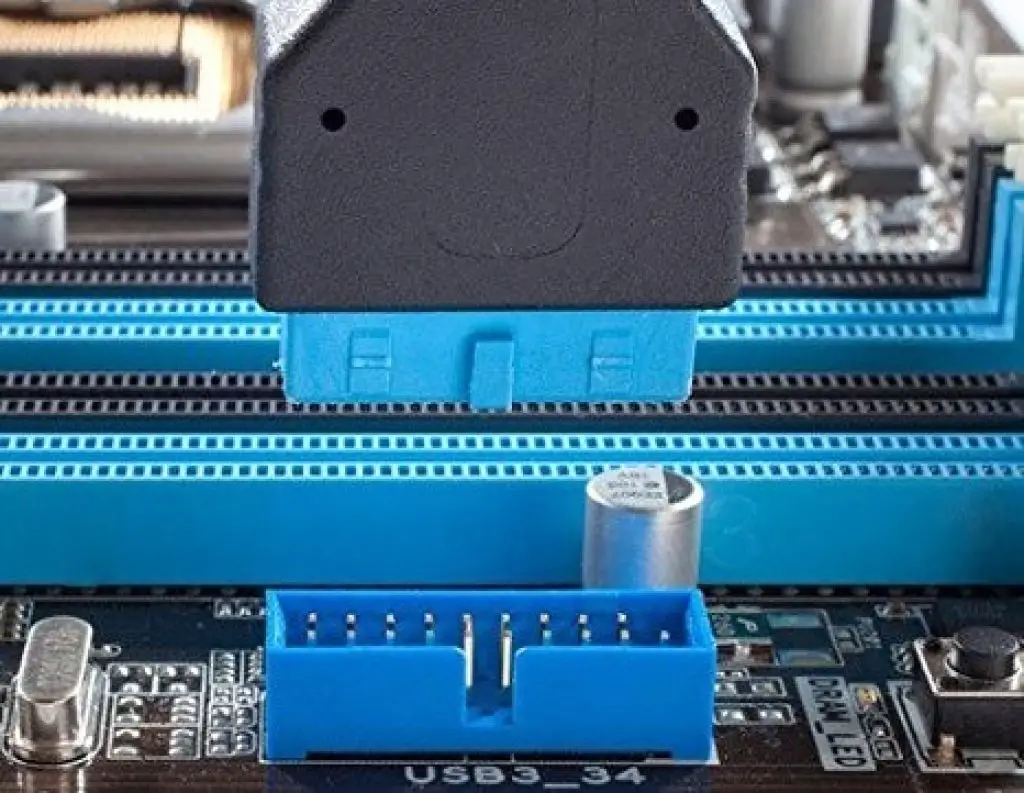

Something like front-panel ports and their cables that connect to the motherboard (this is a USB 3.0):
Those run on their own wires that come with the case, usually hide within the case somewhere, and might need looked at.
I have a case that has USB and 3.5mm on a separate board in the front of the case in separate housing and the PCB is a few mm from a metal piece of the case.
hmm, It’ll check it tomorrow, thanks. although I would guess such a short would at most kill the port?
It might depend on what wire is touching what (could be a lucky ground wire to case ground, could be frayed wires touching, or not connected at all from broken solder); but I’d probably just disconnect all front panel stuff from the motherboard for a quick test first before tracing wires
