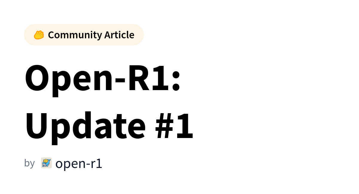

Following the reproduction efforts has been fun
