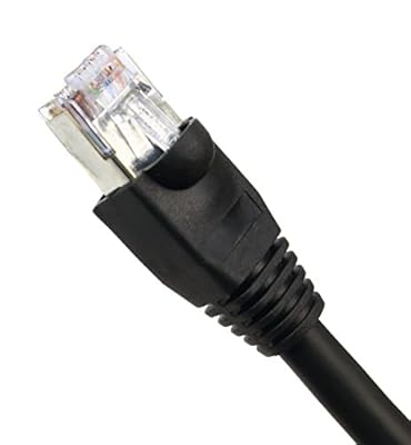

I understand you don’t want to run POE (power over Ethernet) because there will be no ethernet cable. Instead you are thinking of Ethernet over powerline. Theoretically, it should work. The theoretical speed of a PowerLine adapter is in the Gigabit range, and theoretically, there should be no distance problem. However, PowerLine to the birds might figuratively be for the birds. I experimented with the adapters in the past, and they landed in the bin. Noise on the powerline kills the best intentions. Others echo that experience. You might be lucky. Why don’t you run a test, with the “home” adapter in the same outlet as the long extension cord. Alternative 1: If you are happy with snaking a long orange cord through the grass, then why don’t you do the same with an out-door rated cable, such as the one recommended by @CrossCarbon? If it’s direct burial, then you definitely can run it over the ground also. I like the waterhose idea to keep the squirrels away. Also, why not WiFi? Two directional antennas would do the trick.
