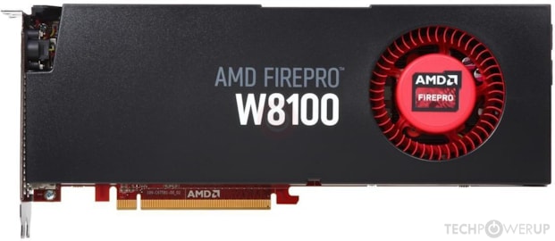

What would be the Radeon Pro equivalent to a 390X, just flash the BIOS from that, or does it need modding?
FirePro W8100 - needs to have 8GB
but i never tried it; heard somewhere that some1 got it working.

In terms of flashing:
AMD Pro cards if they have same specs, and same amount of outputs you are good. They are the same card in reality. I flashed a lot of cards from typical radeon to firegl/firepro including 290x to pro version to unlock fp64 for boinc compute.
I assume polaris gpu’s will also flash without issues. But don’t try it if you don’t have the card, unless you can return it, if it doesn’t work.
It has different outputs than most 390X’s, lots of displayport ports. I don’t know if it’s the same number of outputs.
sometimes its ok. (tho some ports may not work)
