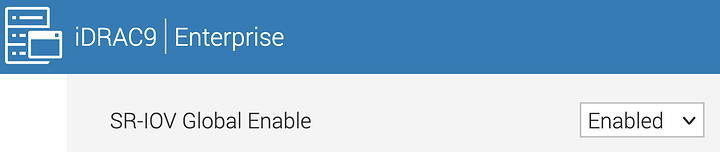

Just went through the 2025-10-19 update with a Flex 140 in a PowerEdge R640 on a fresh Proxmox 9.0.3 install - it got me closer but still no dice.
Everything builds great and goes smoothly until I try to do any vgpu commands in xpu-smi. They all fail the SR-IOV check:
root@arctest:~# xpu-smi vgpu --precheck
| VMX Flag | Result: Pass                                                                          |
|          | Message: N/A                                                                          |
| SR-IOV   | Result: Fail                                                                          |
|          | Message: SR-IOV is disabled. Please set the related BIOS settings and kernel command  |
|          |   line parameters.                                                                    |
| IOMMU    | Result: Pass                                                                          |
|          | Message: N/A                                                                          |

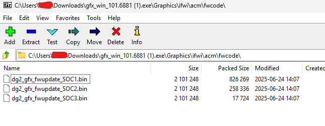

I did get my card upgraded to the 2280 firmware:

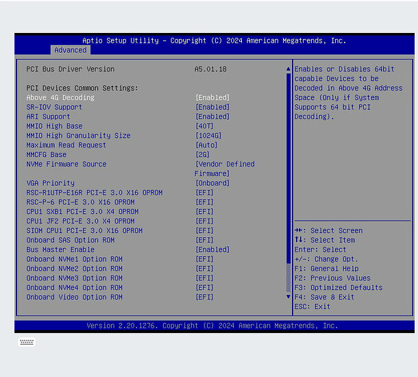

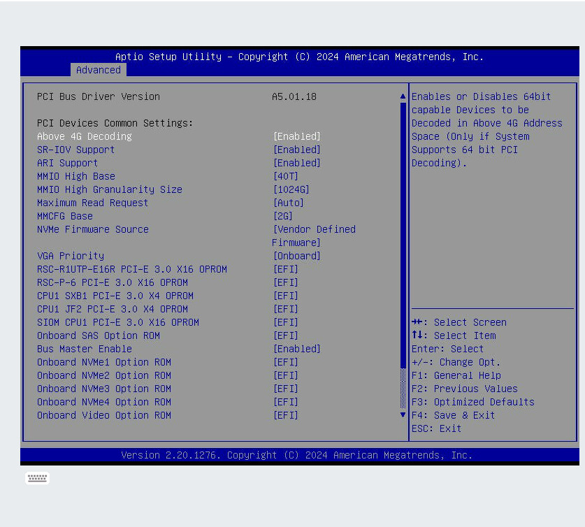

Unfortunately I ran into the same issue as @Jellayy above on completely different hardware. I’m running a supermicro x11 board with rebar support and sr-iov 100% enabled. I confirmed that sr-iov was enabled with a network card.
root@pve:~# xpu-smi vgpu --precheck
|          | Message: N/A                                                                          |
|          |   line parameters.                                                                    |
|          | Message: N/A                                                                          |
The rest of my output is essentially identical to his:

I’ve also confirmed that ReBar is enabled and working on this setup. I do have one last thing to try. I’ve got a c6525 blade system from dell with epyc 7302 cpus, which should be a newer platfrom than the r640 or supermicro x11 systems. I will report back later today on the results from that system
  • MMCFG base
  • MMIOH base
  • MMIOH size
You may need to try some different settings there. try also pci=realloc on your grub default kernel line.
I think I remember having this problem once and set to 56T, 512g, and something else for the mmcfg base.

Not sure if updating to a newer firmware would help? Is the Flex140 firmware compatible with Flex170?

I’m running an Intel 6138 system in these logs here. Still no luck with sr-iov on this one but I have another system with amd stuff to try
It is my turn to join the fun. I have recently acquired a lot of these cards and have been trying to get them working. Once I get the correct power cable for my R740 I will try the Flex 170 GPU.
Test Server
Dell PowerEdge R640
2x Intel(R) Xeon Gold 6248
384GB DDR4-2666
8x 1TB SATA SSD
1x Intel Flex 140 GPU
BIOS: 2.23.0
Proxmox Kernel Version: 6.14.8-2-pve
I am currently having the same SR-IOV precheck fail. This is preventing me from creating the virtual functions.
root@phx01:~# xpu-smi vgpu --precheck
|          | Message: N/A                                                                          |
|          |   line parameters.                                                                    |
|          | Message: N/A                                                                          |
I know SR-IOV is enabled as there other virtual functions attached to PCIe devices on the host. When looking at the lspci output I can see that it looks like it’s enabled (perhaps in a broken state) on the GPU.

Hi SegFault,
Can you also point out to the other people here from where you got the firmwares for the cards? 140/170?
Thanks!

I’m on mobile right now.
It’s a pain in the butt to get them, but you can download the latest windows driver for Datacenter GPU. Then on your windows PC, launch the driver and have the installer extract the files. Go to the location of the extracted files and you can pull the SOC2 .bin file and image the card using xpu-smi.
Once I’m home I can write up the instructions, but currently out all day at a RedHat event.
Tried with a newer C6525 dell system with epyc Gen 3 cpus and no luck. Same sr-iov not enabled message you get. I may go look at the xpu-smi code that generates that to see what it’s looking at.
You can open the installer with 7zip and browse through it:
But I dont think that’s the correct file though …
root@pxvdi01:~# xpu-smi updatefw -d 0 -t GFX -f dg2_gfx_fwupdate_SOC2.bin
Device 0 FW version: DG02_1.3271
Image FW version: DG02_2.2357
Do you want to continue? (y/n) y
Error: The image file is a right FW image file, but not proper for the target GPU.
If your current firmware is DG02_1 then use the SOC1 bin file. I suspect the firmware “flavor” may be different if it’s a 170 since they have some significant differences.
What a huge brainfart …
