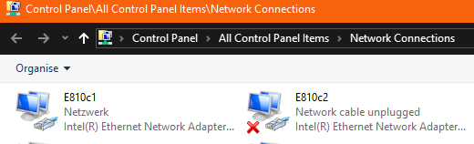

Does the E810 show up under Network Devices?
If it does, it is not a hardware-issue, I think.
