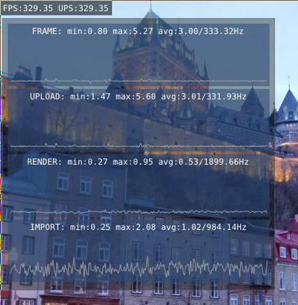

I set the guest with a custom resolution with a refresh rate of 330Hz (the highest my guest GPU will let me set), and LG could with the new D12 capture backend can provide this update rate. If the LG window is smaller I could achieve 200FPS+, but full screen, only 50-80FPS.
Using the zinc vulkan wrapper both on the DG2 and the iGPU in my laptop (UHD Graphics P630), performance is improved enormously. With this in use, my laptop can easily run full screen, at the full 330FPS.

Ok, so another update on this.
While I am convinced there is a performance issue here, further testing needs to be performed as today I got REBAR working on the H12SSL-i with the Intel A770 with a fairly minor kernel patch thanks to some help from Alex Williamson of RedHat.
As it’s his work I don’t want to spoil anything, hopefully this is something that can be upstreamed into the kernel as it’s a bit of a hack. If he decides that it’s not suitable upstreaming I will get his permission to publish it before posting it here.
Anyway, the result is that the performance is now where it should be without the zinc layer, but it does raise some questions.
