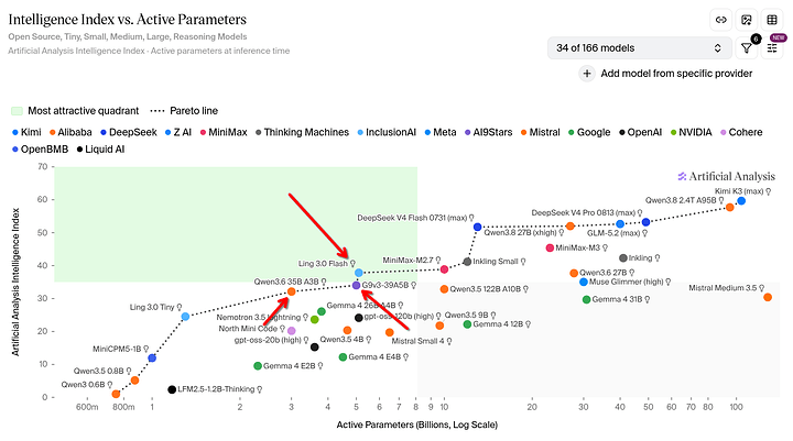

Not a bad option. The cards are fine to run MoE models where an expert is smaller than 6b or so. The cards are bad at running Dense models like Qwen 3.x 27b. The higher the active parameter count, the slower it will be. Plenty good ones to pick around the pareto line:
The further left, the faster it should run on your hardware. Don’t make the mistake of dismissing models based on one or two Intelligence Index points, this is more a matter of “regions“. Also, don’t be afraid to offload a few layers to CPU with MoEs when the 32GB just isn’t enough.
So in that sense the card is great, you get models to run for a low price and you have options in terms of what models to run. I run Ling 3.0 Flash on a Strix Halo, it has more VRAM, but far less memory bandwidth, so i have to look at the same type of models. Ling 3.0 Flash is not for you, but G9v3 and Qwen 3.6 35B are. As well as maybe Nemotron 3.5 Lightning if you don’t code.
