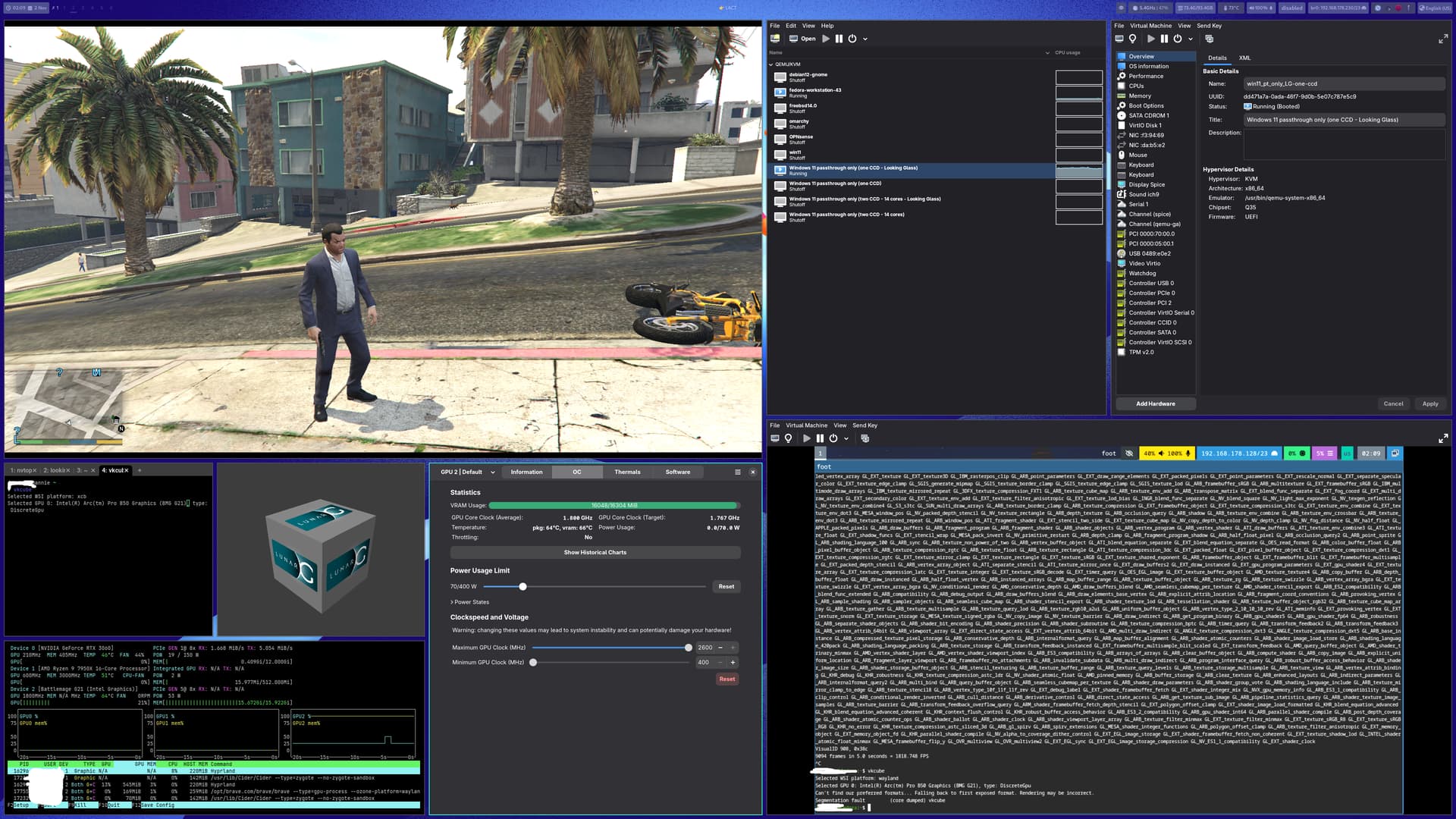

It does seem to work but weirdness ensues on the host whenever VFs are created and the desktop is running on the PF… I believe because all resources are split into the VFs. I hope future drivers give an option to leave a slice to the host (and maybe even to provision differend sized VFs).
At the moment I’m using another GPU for output and using the B50 for VMs. I havent gotten looking glass to work yet (need to figure out how to get looking glass to capture the correct output) but sunshine/moonlight works like a charm, with quicksync working in the VM to get smooth encoding. Realtime 4k120Hz with some lag but barely noticeable. Maybe not good enough for gaming (depends on the game I’d say) but definitely a very smooth desktop experience.
EDIT: Looking glass is now working too with the VDD driver. Perhaps there is another way, but I got it working by disabling the virtio GPU’s display. Otherwise the VDD display wouldn’t attach to the B50.

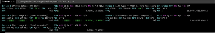

I did some more tests with the B50 as the main GPU on a host linux system and passing two VFs through to a windows and a linux VM. Things were better than I described before. The only issue is running out of VRAM on the host. After making VFs only about 200mb is left to the host and it’s okay for browsing and youtube but nothing more. Vkcube can run on host while playing GTA V in the VM. But once I launch heaven on the host things get very laggy and will crash if i don’t close it fast.
On the linux VM the xe driver does load on the VF, but no acceleration… I guess the linux driver is not working for VFs yet? Which is funny, since I can prime offload to a VF on the host. Running heaven on the host on a VF does work, but makes the VM behave very weird (looking glass crashing, and only resuming once closing heaven, for example).
So it does work, to use the B50 to display the host and have VFs passed through, but don’t plan on doing much more than browsing on the host, unless we find ways to reserve VRAM on the host…
I thought maybe I’m smart, and I’ll see what happens if I run some game or benchmark on the host to ‘reserve’ vram before creating VFs, but this just crashes the desktop with an OOM error… Ideally we could get a way to, say, create one 2GB VF, one 8 GB one and leave 6GB to the host, or so…

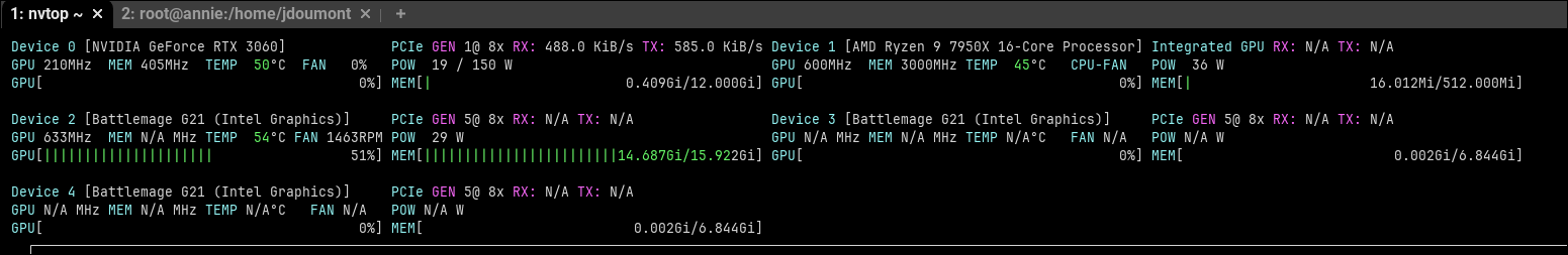

EDIT: Despite the crash, this actually has worked!! When creating VFs while some VRAM is in use, I get:
When creating VFs when nothing much is occupying VRAM:
So I’d need a script that allocates, say 4GB, of VRAM, then creates VFs, then clears it again, leaving 4GB to the host :thinking:
