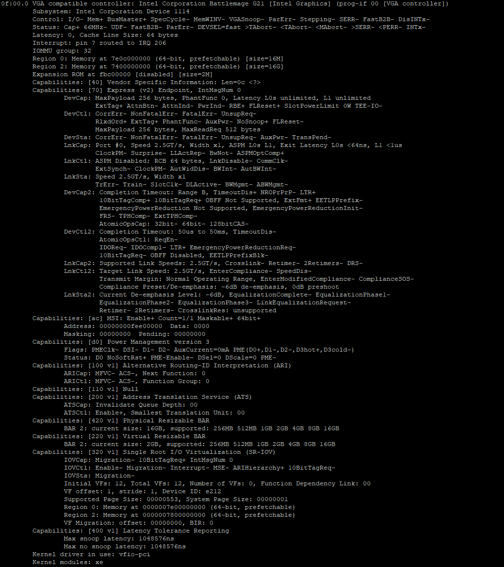

I used the command:
“echo 4 > /sys/devices/pci0000:00/0000:00:03.1/0000:0d:00.0/0000:0e:01.0/0000:0f:00.0/sriov_numvfs”
I did install on bare windows and got it working as a single passthrough card to a VM. Please see the readout i get…

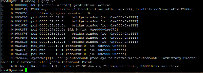

what is the output of dmesg | grep xe?
Double Checked Driver version 32.0.101.8135 from 09/30/2025
Here you go…
Strange… There are no messages from the xe driver at all… This is how mine looks:

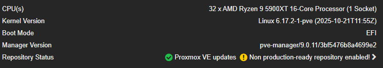

Which OS/kernel are you running? And components? Resizable bar enabled, and other bios settings (iommu, sr-iov, etc.)?
I just updated proxmox to 6.17 last night.

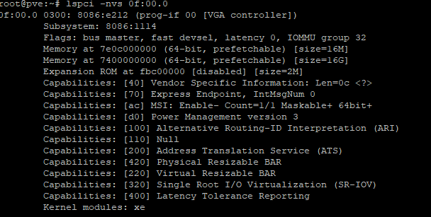

From what I can tell i’ve enabled all the bios functions. I just eneabled it back on a passthrough VM so you could see what i get using lspci -vvvv command.
Oh, I see the issue. You need to let the xe driver load on the card, then vfio on the virtual functions. So you’d need to remove vfio pci id of the B50 from the kernel parameters. The VFs created can be easily bound/unbound on my machine, so no need to worry for now about blacklisting or kernel parameters.
After the VFs are created you can pass them through, they should (un)bind automatically (at least they do here). Or you can echo 0 > sriov_drivers_autoprobe so that the xe driver doesn’t bind them.
If you’re not sure which kernel parameters are used: cat /proc/cmdline
I don’t think the i915 driver even binds battlemage devices, so no need to blacklist. And you should let the xe driver bind, since this is the one that allows the VFs to be created.
