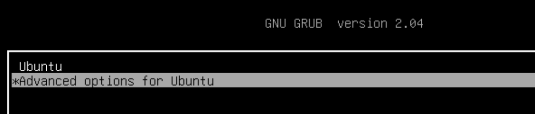

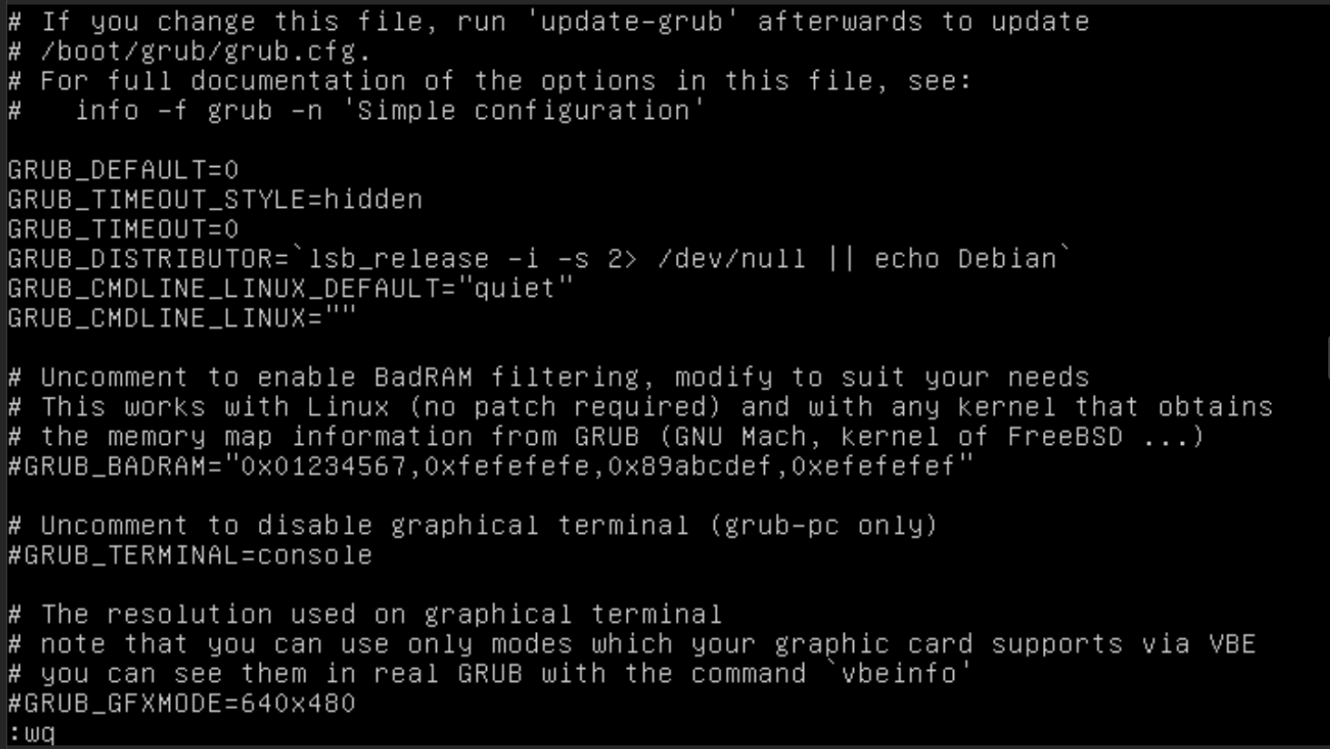

Hurdle 1: No Login Prompt after Installation
I suspect the system did install correctly, there is a broken configuration somewhere that stops the login prompt from showing up.
After Google-ing, this is a known issue (documented here).
To resolve:

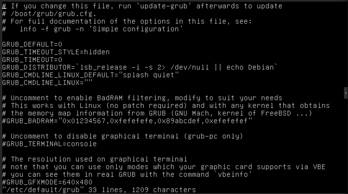

Stop the VM > start it up > press Escape during the boot up process to bring up the boot devices menu > select the drive you installed Ubuntu to > select Advanced Options for Ubuntu > Recovery Mode > root: Drop to root shell prompt > open /etc/default/grub in whatever editor tickles your fancy > remove “splash” from GRUB CMDLINE LINUX DEFAULT (before and after screenshots below) > run update-grub after saving changes to regenerate GRUB > reboot, and enjoy a login prompt.
Failing to show login prompt
Original GRUB
Edited GRUB
After GRUB Changes: A Login Shell

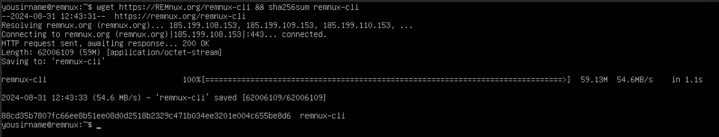

Download and check the SHA256 hash against what’s in the REMnux guide.

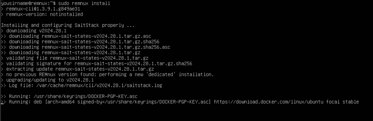

Initiate the REMnux Installation script. This will take a while.

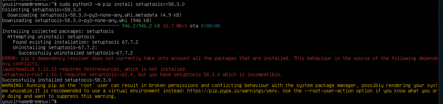

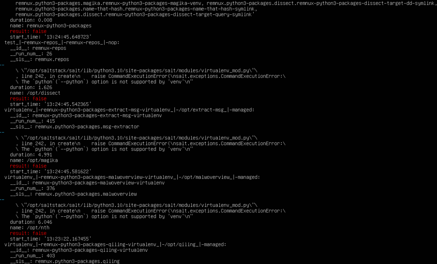

Hurdle 2: Install Failed: Update returned exit code not zero
Investigating errors in /var/cache/remnux/cli/v2024.28.1/saltstack.log - Python option is not supported by venv
I suspect there is a dependency mismatch somewhere - setuptools 67.7.2 is installed and there is a dependency somewhere that is not compatible with it.
Attempting fix in this Github issue (here).
Regressing setuptools to 58.3.0:

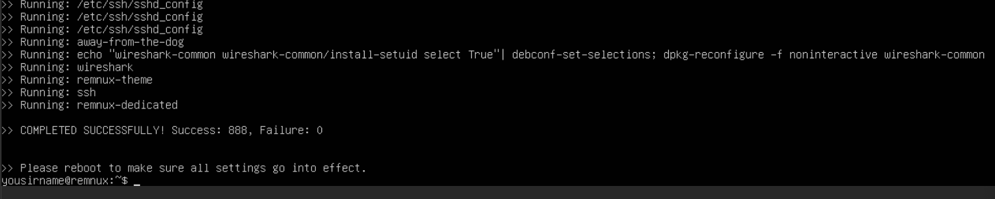

Installation is successful:
Update: I’ve built it again and the remnux installation went through without any of the dependency regressions.
