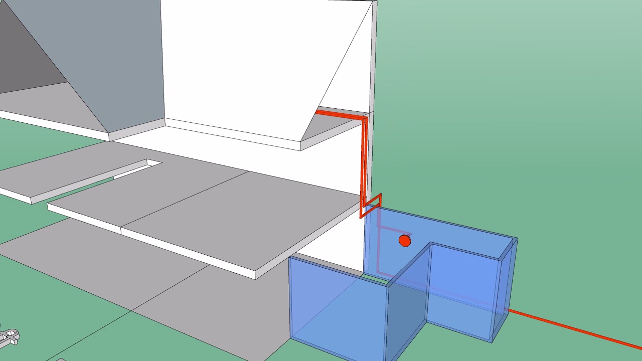

If you’re interested in a visual, here’s a little thing I made, just in case it helps.
