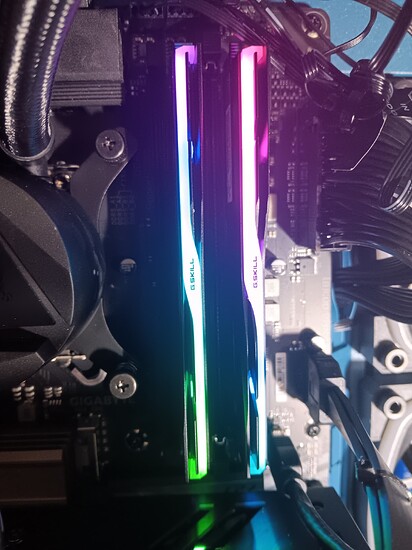

The RAM is supposed to be staggered correct? One stick goes into slot two and one into slot four? And I’m sorry Molly I’m not sure what you mean so I sent a photo of what I meant by lit up.
The watercooler isnt powering up nor is the grapics card the. The fan isn’t even kicking on when i turncon the power supply
Correct, should be one in slot A2 and B2 (or 2nd and 4th from the CPU out).

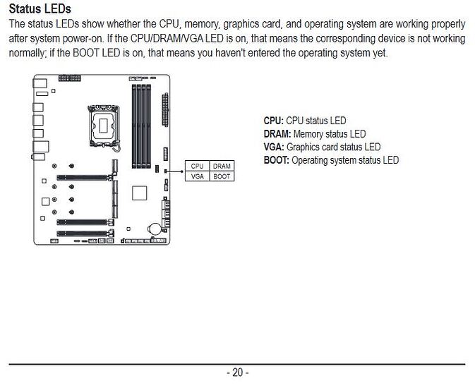

For the status LEDs, they are these four things here:
statusLEDs
You’ll want to watch these while it’s trying to boot up to figure out which part is misbehaving. For which one corresponds to which bit, it’s in the manual on page #20:
So what I’d do is press and hold the power button for 4 seconds to shut it off, then once off unplug it for 30 sec. After that, plug it back in, start it up again, and watch the status LEDs.
Yeah unfortunately I’m not getting any lights on them four. :confused: frustrating to say the least

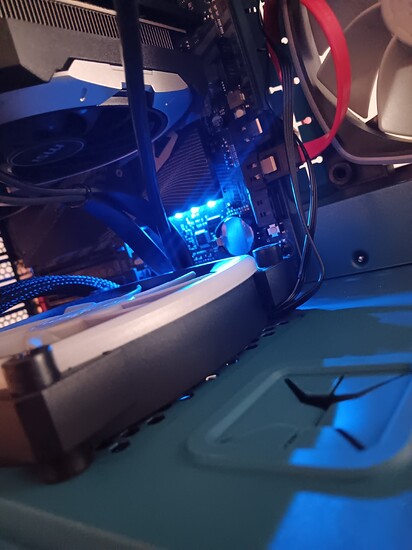

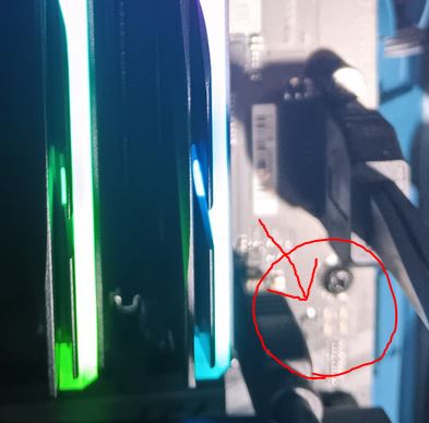

I did give the specific CPU, the power supply was no good so newegh sent me a new one, but now it turns on and will run for about 3 minutes maybe less then it will shutdown and then start back up 15 seconds later run for another 3 minutes and then shut back down with these weird lights at the bottom of the motherboard. Picture will be added…
Any thoughts on that issue? Thanks for the help so far ladies and gentlemen.
