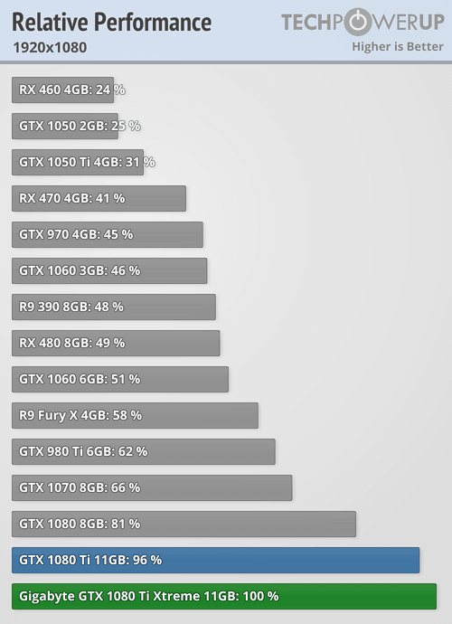

You are seeing the same performance, because it is basically the same performance...
This is a review from a week ago... 390X is basically 2-3-4% faster than 480, and that means in many games 1-2-3 frames per second. Yes, it's basically the same performance...
Even 5% faster in most games will be 4-5fps, and you will never notice the difference between 80 and 85 fps...
So no, your CPU is not a bottleneck.
