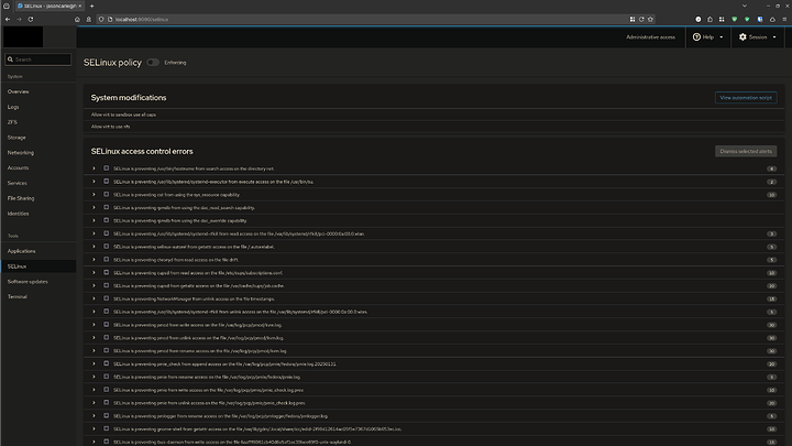

Basically, I am running Fedora 41 on my desktop and it runs fine, if I disable SELinux. If I enable SELinux, it doesn’t run at all. I took a screenshot of the SELinux logs in Cockpit to show the scope of the problem. As a noob to linux, I am entirely out of my depth trying to figure out how to fix this problem. It appears something has gone completely wrong.

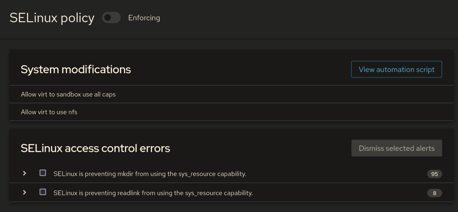

It appears this is working. I ran this command, and cleared all the prior alerts. At the moment, this is all I have and it is remaining steady.
