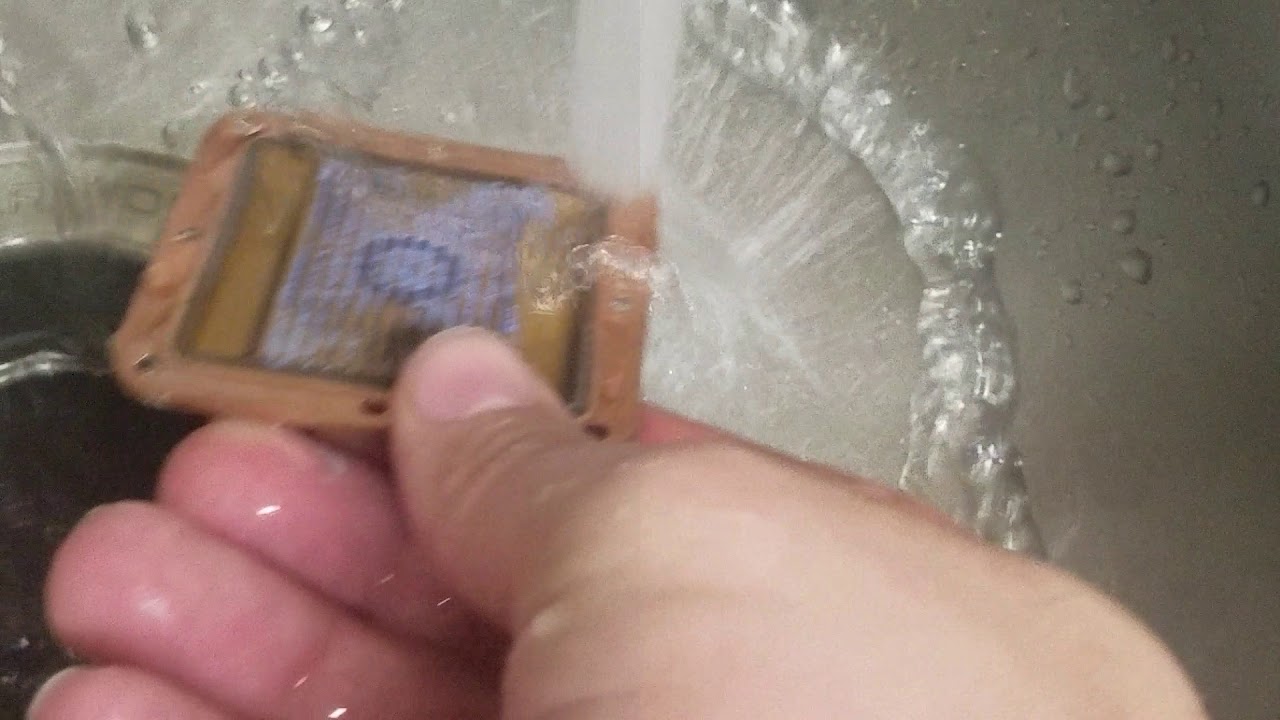

I literally only had this bullshit in my system for about 4 or 5 weeks and after the first month I had already called the RMA Department because the fluid head completely disassociated
so this is how hard this shit sticks
Yeah, this is really a bummer. I don’t really know if alcohol would clean that shit out or not, but I know it won’t damage the metal, so it couldn’t hurt. Just go down to the walmart and grab a few bottles of the 70% stuff and run that through the rads a few times. Should be pretty cheap. Really shake them up. Also get a plastic or nylon bristle brush from the kitchen area for cleaning the fins out on the blocks. Or a toothbrush like you said in the video.
After all that you’d probably be best off to assemble the loop separate and run water through it a few times.
Toothbrush and mildly painful hot water later
Give it a good soak in hot water for 5 minutes, and scrub it when it gets cool enough to handle.
