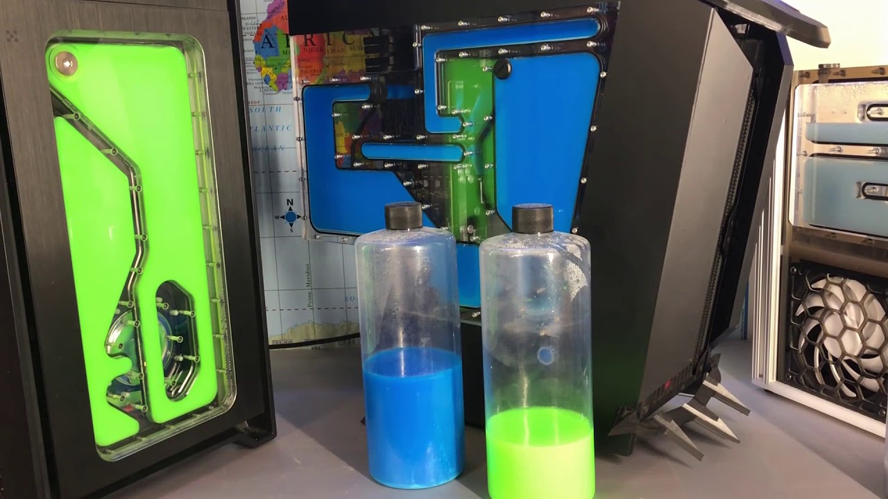

This was a primochill Vue coolant with all primochill advanced LRT tubing
And it went South so fast it was less than 2 months

In january i got my 3 bottles of primochill vue blue
And i replaced my distilled water.
At the end of january my fluid had completely disassociated and i started talking to their rma depo.
They sent me 15ft of softtube
Think i should talk to them about how fucked up my whole loop is?
