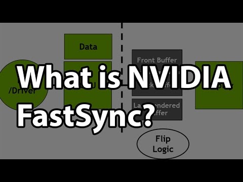

The GTX 1080 has fast sync. What will that do when vsync is off?
@The_Space_Bear I dont plan to use freesync at all with the GTX 1080 it will be always disabled ;)
Fastsync is basically you run the game with vysnc off, and then the GPU will send out a completed frame on each interval.
so lets say you're running a game at 100fps, the GPU will render all 100 and send out 60 or so.
Vsync the game will run at 60fps no mater what, and the GPU will send out 60 frames to the monitor, this has draw backs and when the game goes below 60fps you get bumped down to 30 fps.
off, game runs at 100fps, and the monitor gets what ever is in the frame buffer, which is someitmes two different frames, which causes tearing.

Sorry, I dont get it? so with Vsync off and fast sync enabled, The gpu produces 100fps but you will only see 60 on a 144hz monitor?

sorry was out, I used a 60hz monitor for my example.
for 144hz, it would display all 100 frames, then duplicate 44 of them so you would have some repeated frames.
I suggest you watch nvidia explaining it over me
Fastsync is good as it eliminates tearing like VSync but without stalling the render pipeline and therefore adding noticeable latency. Fastsync still adds some latency but it's very low and preferable to tearing. Also able to compliment G-Sync as well if you bought a monitor with that feature.
