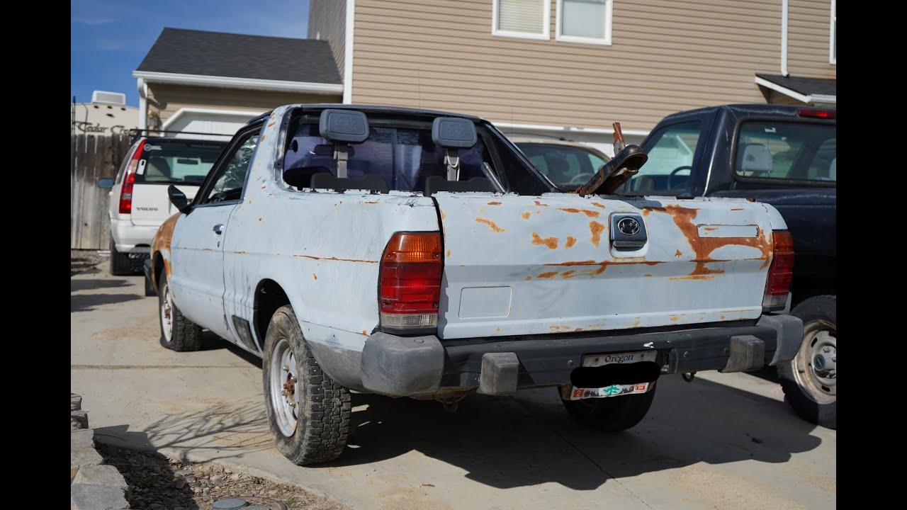

I Bought a Subaru BRAT

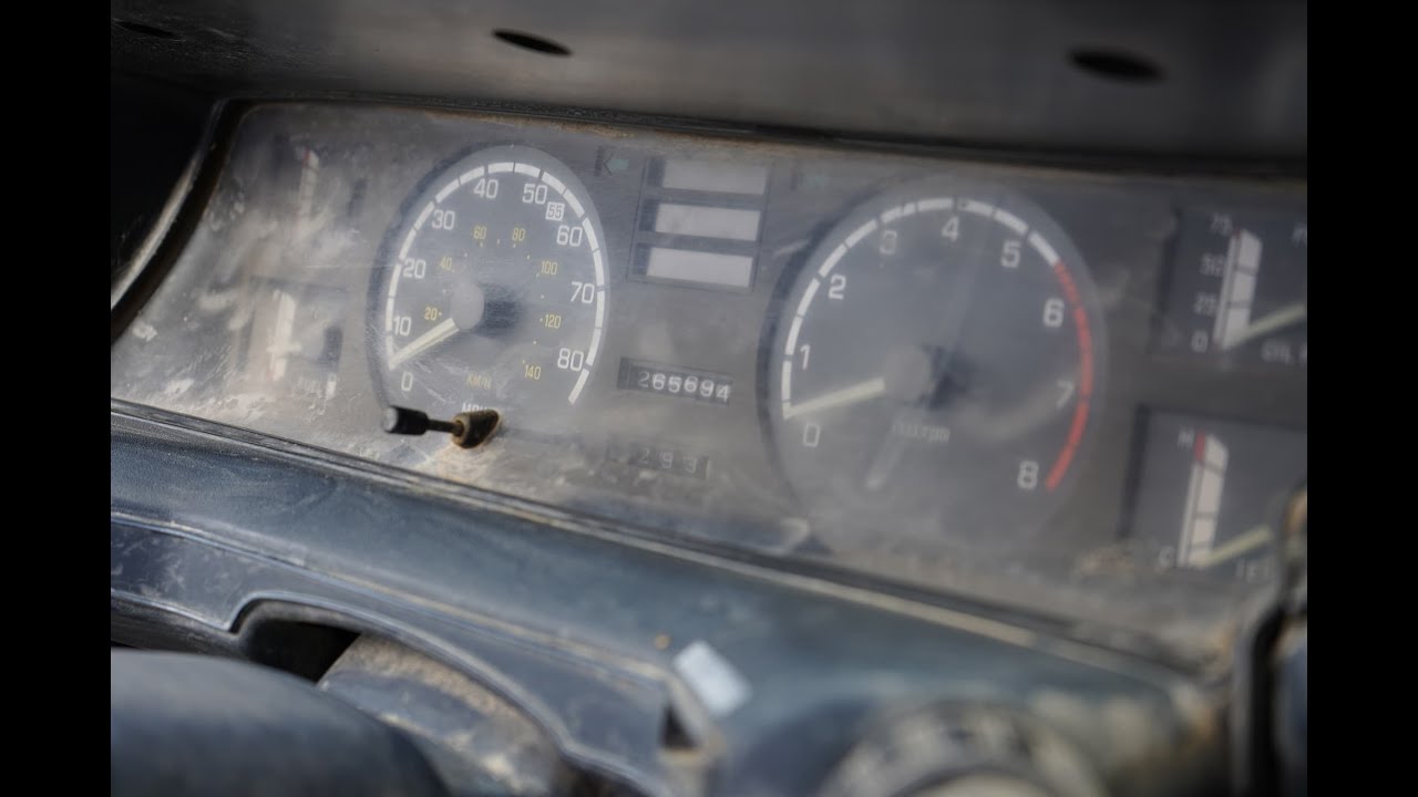

So I’ve been cleaning her up, and I just found out that she’s no spring chicken.
265k miles on her
Cleaning… progress?
This thing was gross.
Still have to get the carpet under the center console out, since it stunk and looked so gross I didn’t want to get in to remove the center console. It already smells better, but it’s still not great.
Also I went around tapping and looking all over for bad rust, and I really didn’t find much. There were 2 spots that had rusted through.
Front lower corner of the right rear wheelwell.
Same spot but inside
And under the driver door
Driver footwell. I was worried this was going to be bad due to the broken out windshild, but it all sounds like good metal. Looks kinda bad, but it really isn’t.
No other rust worth mentioning.

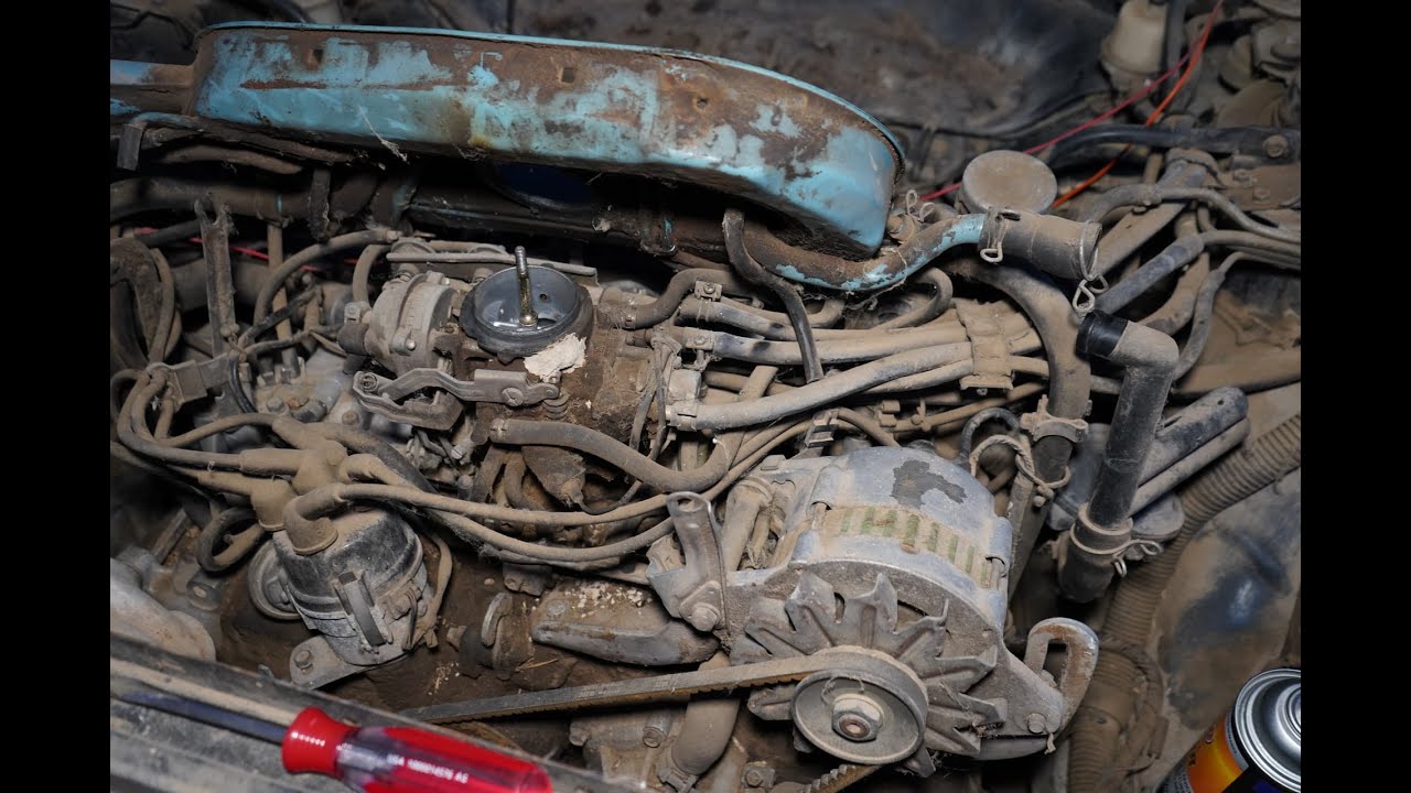

There wasn’t an air filter in it.
I got the air box kinda pulled back to get a closer look at the carb, and I really don’t like what I’m seeing. Looks really small, and there’s still way to many bloody vacuum lines.
Alright, I gave her jab with the old screw driver, and she came alive… after much cranking and carb cleaner.

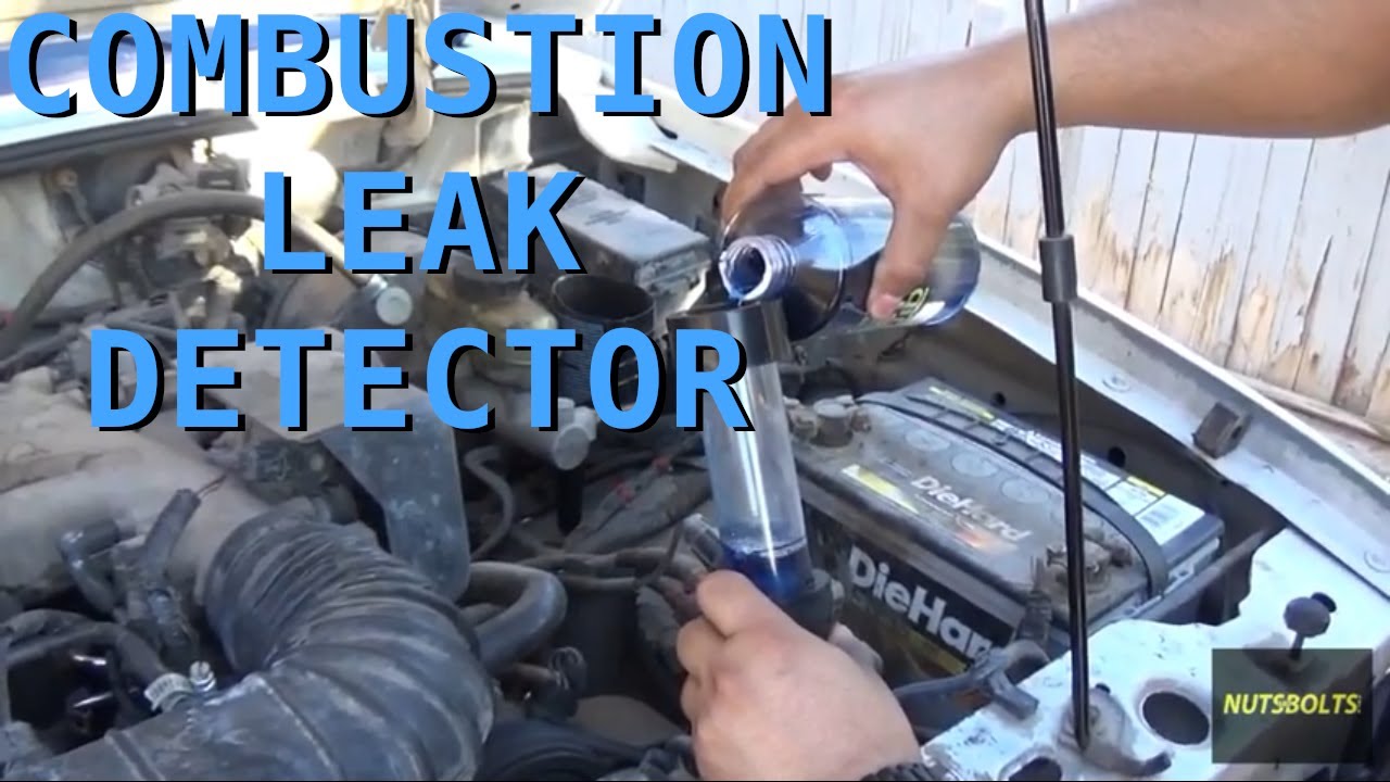

@TeckMonster , you could probably get one of them cheap testers, to verify if exhaust is mixing
That’s cool. I think I’m going to pick up a thermostat tomorrow and if that doesn’t fix it, then I’ll get me one of those testers.
