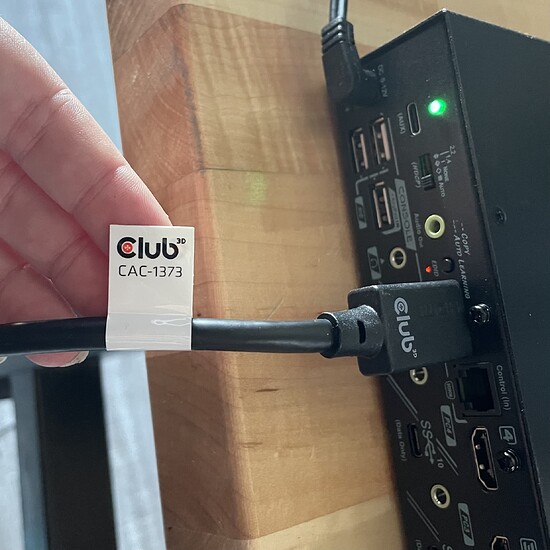

I actually took a video today of our HDMI 2.1 KVM working at 240Hz on a 4K OLED with HDR:
I used these cables:
