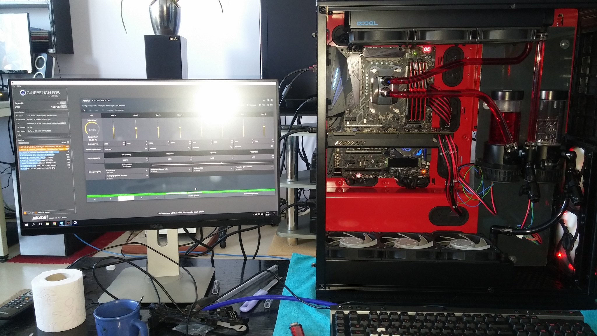

I’m picking up two 1080tis with waterblocks soon. I want to put them on a separate loop, and probably toss my NVME drive on that loop as well. Currently, I have two pumps pumping through the VRMs, PCH, fan controller, cpu, and nvme drive.
Now how would I ever fit a second loop in with a reservoir, and two pumps? Best choice pickup a CaseLabs case, or that new Phantek? I could mount the reservoirs on the pumps freeing up some space, but I’m worried that won’t be optimal for flow and noise.
If you are going to fit a second loop you need to completely redesign both, cause this is a mess as it is… There are hoses and stuff everywhere. Clean it up, think it through and go again…

It’ll imrpove a bit by putting the second loop in. I won’t have to cross down anymore to get from the top to the bottom rad. I’m almost tempted to sell this case for an Enthoo Elite or CaseLabs just so the top rad doesn’t crowd the mobo in a push pull configuration.
Do like me and take out the drive cage, have a look here,
20170902_181531[1] by denstieg, on Flickr

Its a big case with a absurd amount of drive storage, was planing on keeping the 5,25 drive space but i like the open space. On flickr there’s a photo with it stil there. And dual loops eat up space like crazy.
