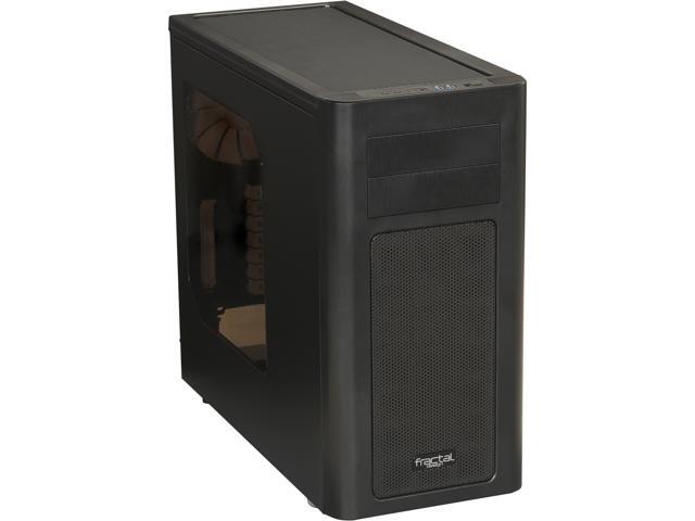

I am currently researching... I want to ask how to remove paint from metal surface, specifically grill...
I know sand paper can do the job. Here is the thing - I want to be able to also remove the paint from inside the grill's holes.
Repainting it later will add extra layer and close the holes, reducing the air, that can go through there...
Let's just call it as is, I want to turn this:
Into this:
Without the window mid, obviously... I am not that good.
So should I worry about killing the airflow by adding extra layer of paint on the grill, and by extension, is there an easy way to remove the paint from the grill?
